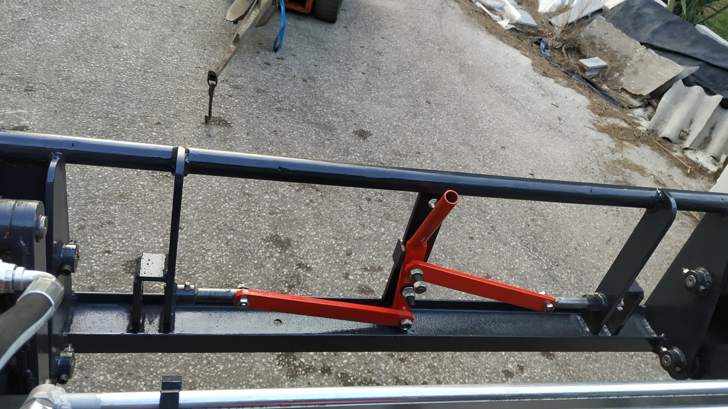

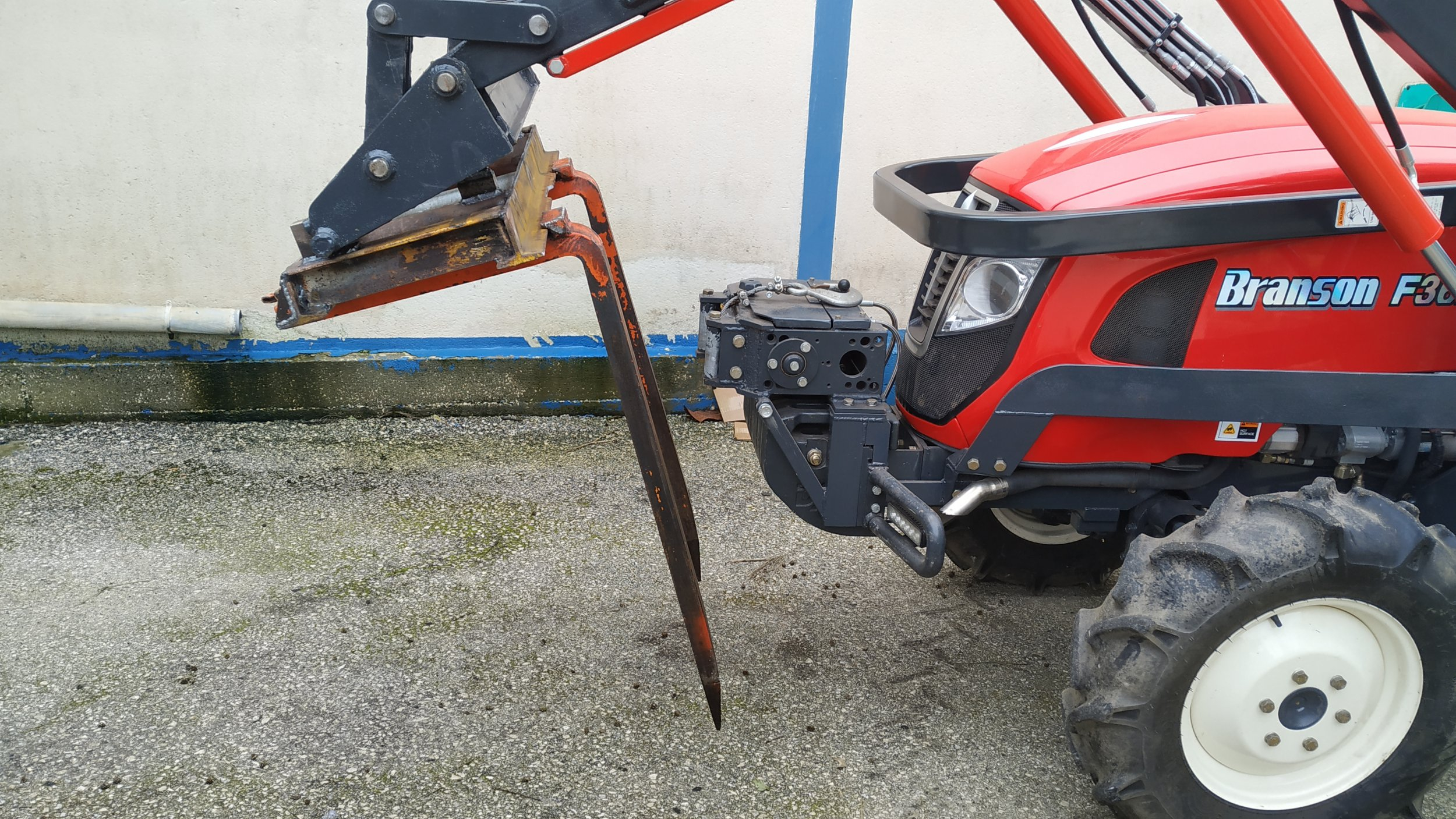

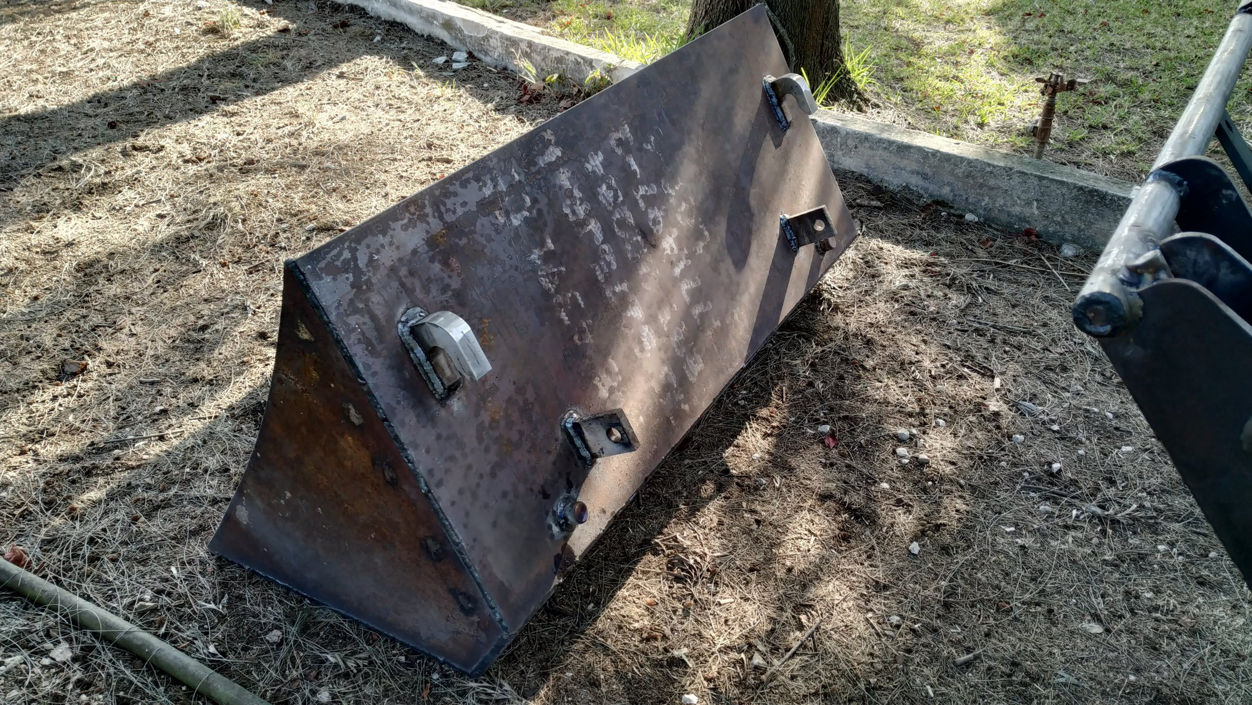

Ok, here is what I have.
I have a drawing with the dimensions. I used the bottom one, the Euro style.
And some pictures of my loader:
This is some of what I have. Let me know if this helps you or if you need anything from another angle or something. I can take some more pictures tomorrow if you need.

Ptsg - on your bucket you've got what looks like a bumper - does that make\stay in contact once it's attached? I see on the forks it looks like the only points of contact are the 4 connect points?

   / Euro/Global attachment info/pics please #7
So, the hooks on top just sit on the round bar. The bottom eyes/tabs is where the pins go through. Then I added two hard stops (one per side), the function of the hard stops is to hit the quick attach frame so the holes on the eyes/tabs will get perfectly centered with the pins.
Doing this way, makes it much easier to connect, otherwise you would need to manually move the attachment, while also moving the locking lever and hopefully you can the right spot till the pins go in. Would be a very hard task to do.
Hopefully I explained this in an easy way to understand. Another advantage, although not sure if matters or not, is that I can release the pins even if I had a load on the forks or bucket. Basically those pins rarely get any load, usually only with applying downforce.
On the forks, I do have the hard stops too but I didn't on a different way. With the forks, I had to make the lower eyes longer so it would give me enough roll back with the loader sitting near the ground level.
Oh, and yes, I did add the grease zerks on the lower pins.
