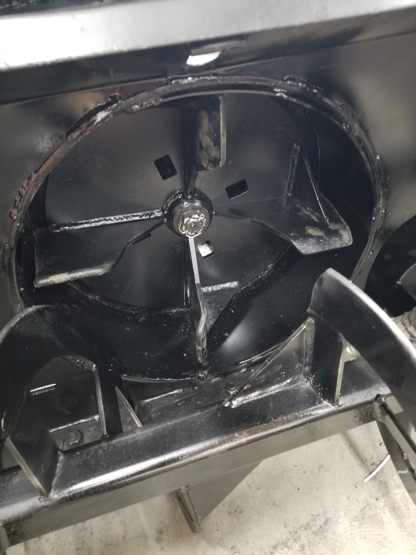

My hydraulic blower is quick attach. Its beefy as he**. Going on its 15th winter of use. Auger for mine. The only thing i had to replace is the liner around the fan. I have lots of rocks that creap into the snow. After 12 years i got a hole. I just rolled a new piece of 10g steel and spot welded it in.
