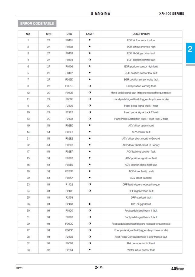

I don't understand how to correlate what is displayed ("F11") to the service manual. Was there any other number displayed? Here is a sample of codes, but nothing relates to "F11". This is for the 4100 series engines.

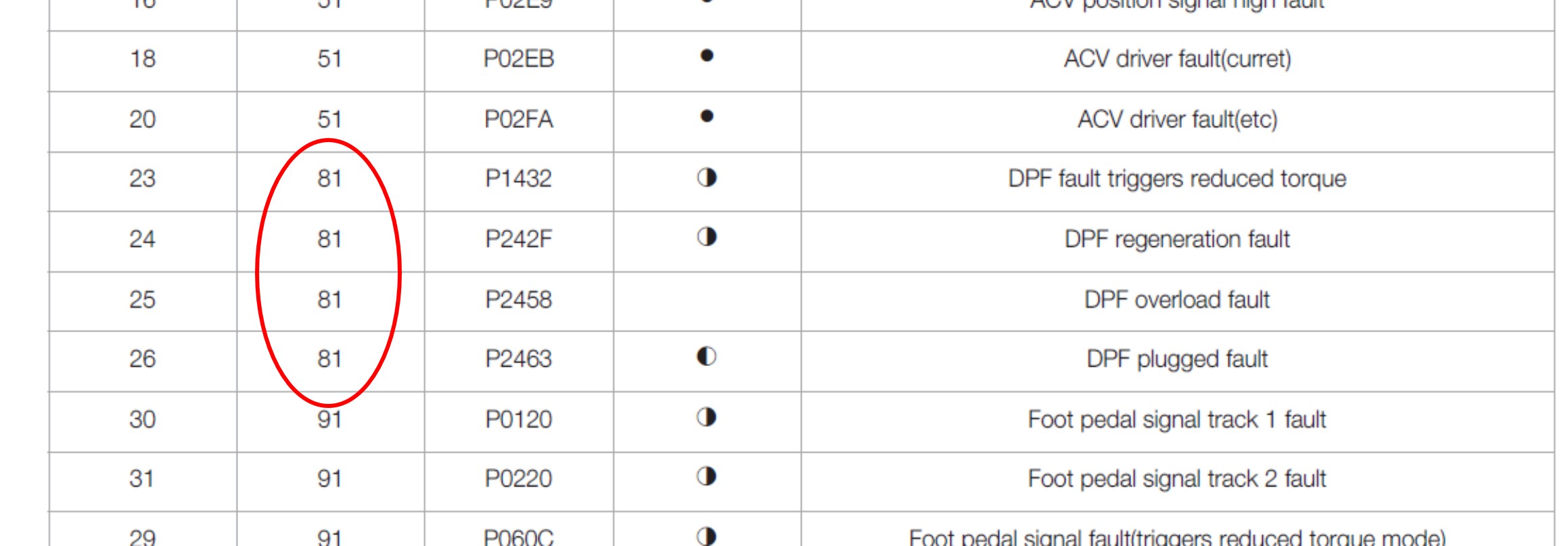

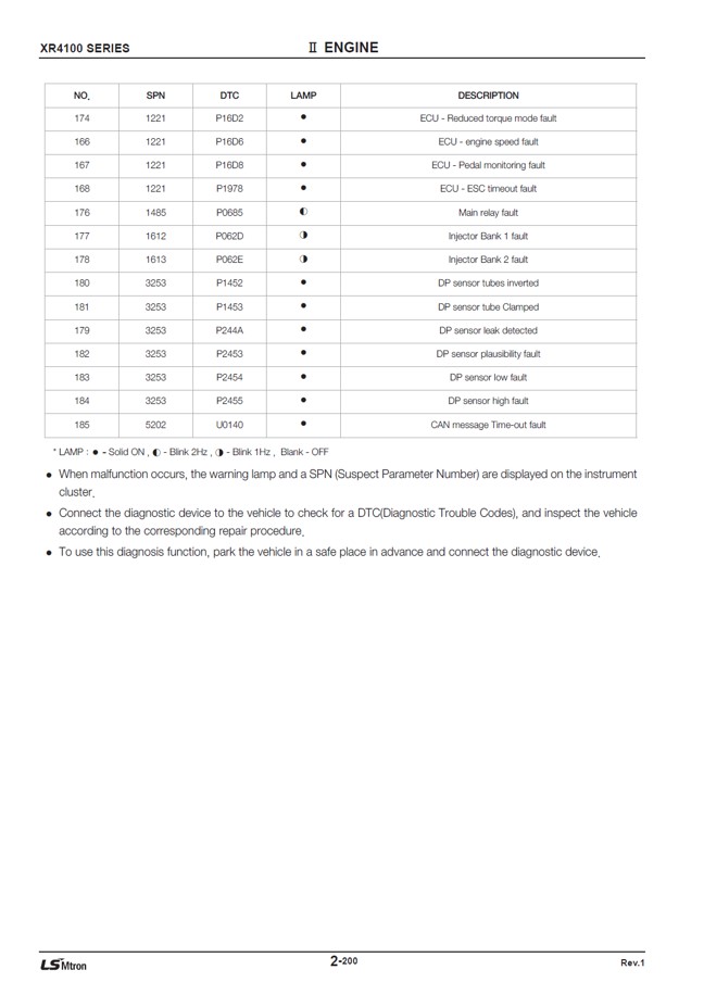

"81" is the Suspect Parameter Number (see my previous post with pictures of descriptions).
I circled it here:
Since it was blinking, it must be one of these diagnostic trouble codes associated with "81"
DTC P1432 (slow blink, every second)
DTC P242F (slow blink, every second)
DTC P2463 (fast blink, every 1/2 second)
I still don't get what the "F" numbers are for and there is nothing in the manual about reset. It's kind of sketchy as I assume the dealer software can do anything they need to. It must go away since the dealer said not to worry...might take a few engine cycles like some codes on cars(?).
Hope this helps.
