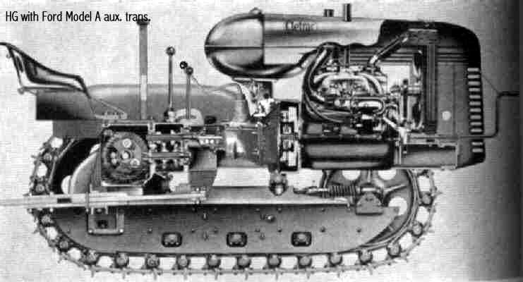

I had an OC3, it was an AG tractor designed in the late 1930's. Mine had a Ware loader on it.
They are not geared low enough for serious dirt work, but there is a solution, add a Ford Model A transmission ahead of the 3 speed transaxle: Cletrac.org - Auxiliary Transmissions
