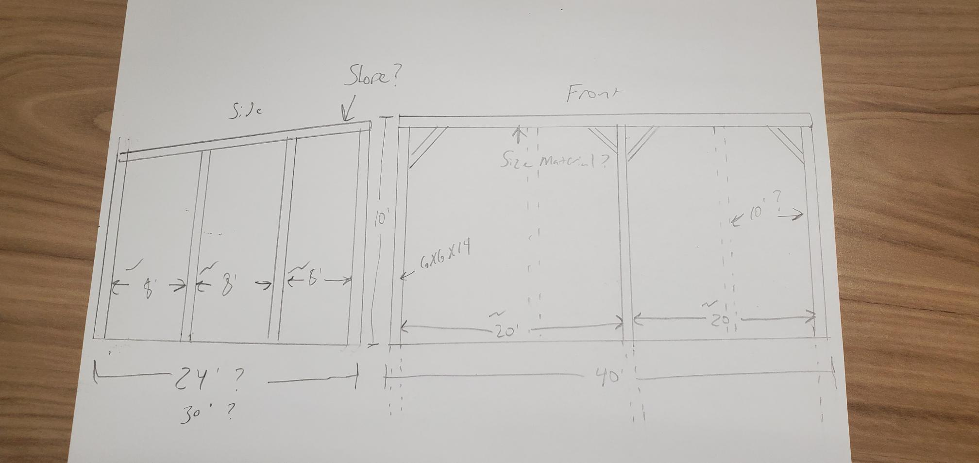

Price a 20' board vs two 12' boards and report back ;)
With no snow load to worry about I'd probably tripple up some 2x8/2x10 for a span like that with gussets. However you won't span 30' so easily, you'll need at least one support preferably two. I like to lay out buildings I'm building by the material available at my price before arbitrarily throwing some sizes around. Also, there's a program called "sketchup" you can download for free. Check out some youtube videos on how to design and layout sheds with it, very powerful tool in planning and building for us professional hobbiests.

20 foot spans are doable with the correct LVL beams. They are pricey however.

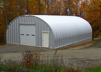

steel carport building ...

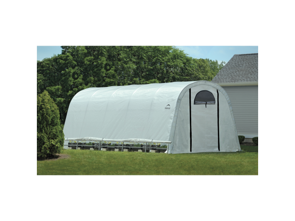

Look around for a used half round Fabric Storage unit . Sometimes people get rid of them cheap if the top Tarp is shot . Then install steel roofing on the frame with self tapping sheet metal screws . My neighbor did this to two of these and they have been up for ten years or more . He said it was about $700 for the steel and with one guy helping they did both in one day.

Let me put a visual aid here. I'm no artist but something like this is what I have in mind. I haven't had luck finding any used enclosures and as you know steel is pretty steep right now. I may deck and shingle it as I think it would be cheaper than steel panels right now.
Am I on the right track?

I did a 32 x 48 pole building, poles ever 8 feet on the 48' side walls and 32' clear span, I did wall in the ends, but the spec allowed both ends to be completely open without any posts. Mine was speced for heavy snow load so if you don't have that worry that is awesome.
