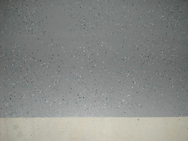

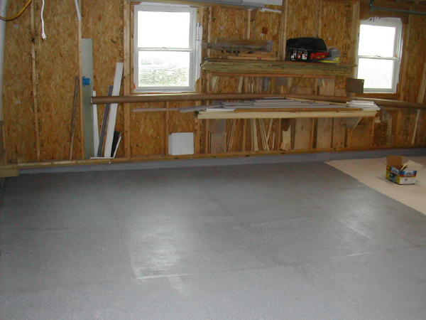

I used kit by Rustoleum, sold at home depot, at least is was a couple yrs ago. It still looks good after a couple yrs.
Make sure you clean the concrete very good as directed.
Because of the garage size, I used 2 kits, and put the leftover on part of the basement floor.

closeup pic.
