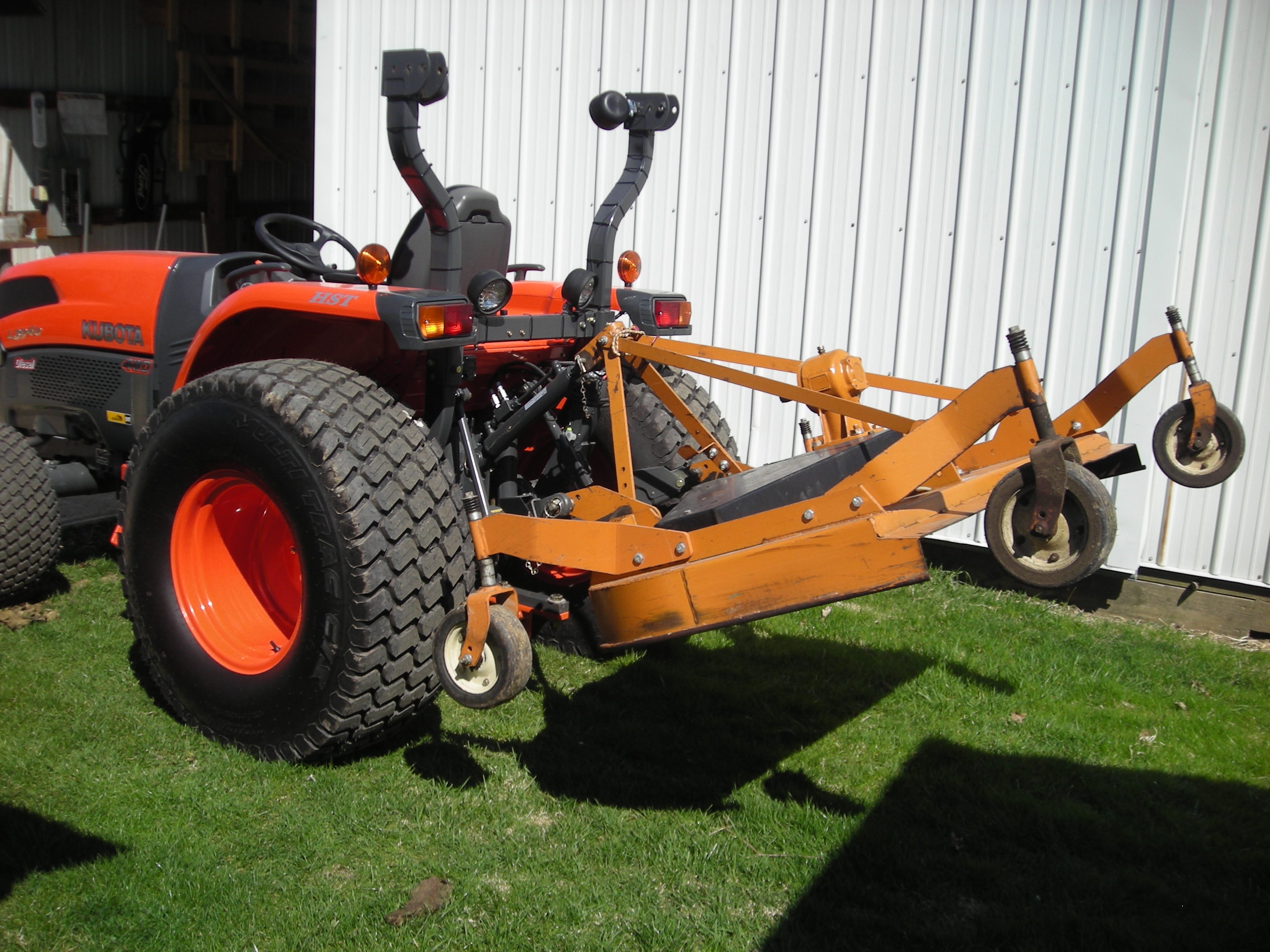

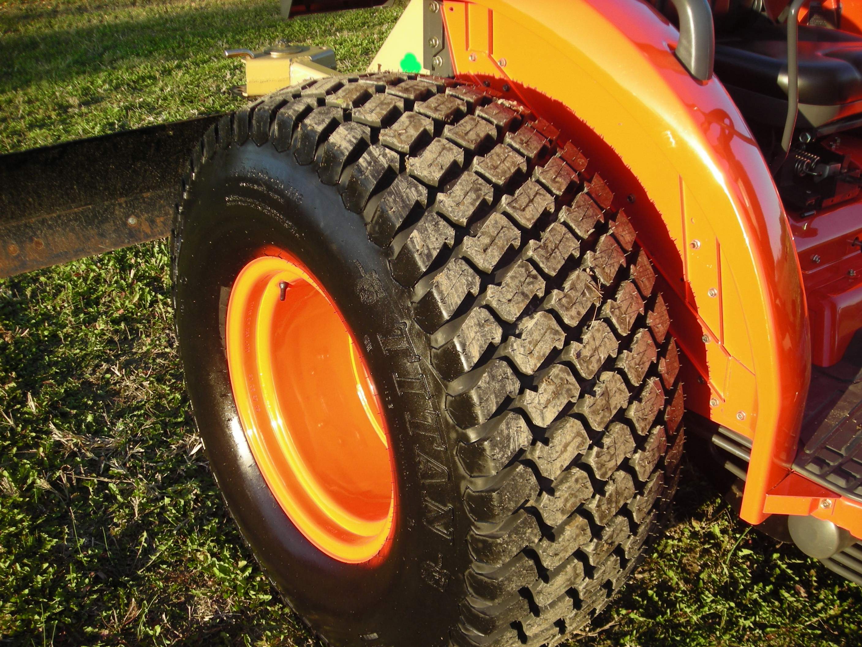

How much time do you have? I mow 2.5 acres every other week with a 6' rfm. Parts are a little bumpy, so I set my cruise at 4.5 tp 5.0 mph. With warm up, obsticles, and such, takes me about an hour. Personally, I prefer turfs. Philip.
