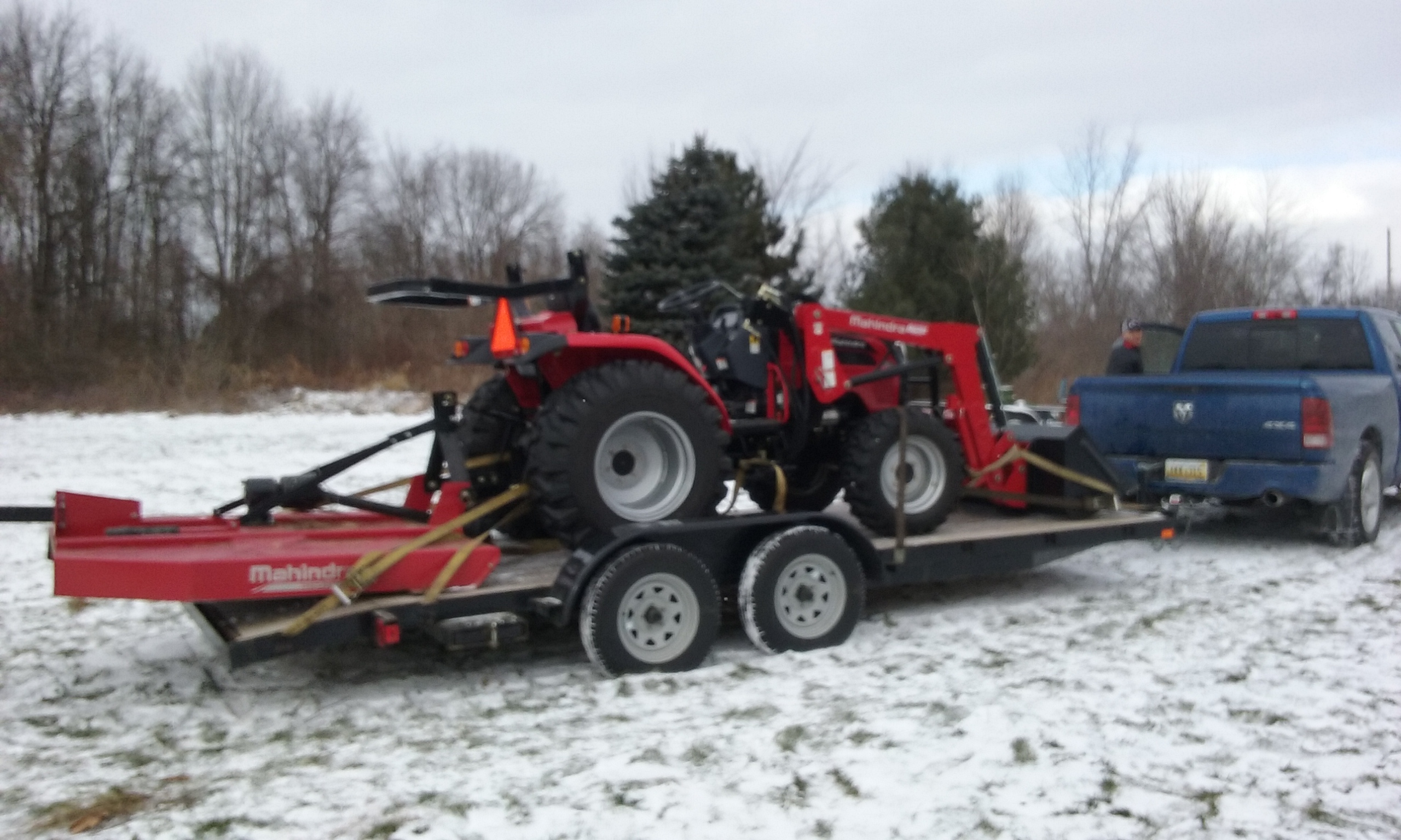

I'm just dropping by to share my early experiences as a newbie tractor owner with my new (to me) Mahindra 2540, which is built by TYM in Korea. It appears that for all practical purposes, this tractor is a TYM T394 with a Mahindra badge (excepting for the Mahindra engine). It's a 12/12 shuttle shift transmission with FEL and ROPS. I've moved some snow and dirt with it, pulled a couple trailers (one 7000 lb and the other 8500 lb) with a Titan 3-point hitch receiver, and I'm anxiously awaiting to use my new Titan 48" pallet fork attachment. My initial impressions are positive, with the machine quick to start (in 15-25 degree temps), runs clean and smooth, FEL controls are responsive even at low RPM, tons of torque even at low throttle positions, clutch use and shifting is smooth, and the suspension seat is very comfy. The 40HP engine is unique as it has no DPF (diesel particulate filter) nor does it require DEF, which is unique in the industry. Two issues that I'll have the dealer address are erratic engine operation at higher speeds (dealer says an ECU flash update should cure that) and the 3-point hydraulic lift is jerky when raising (lowering is very smooth). I've crawled all over and under this tractor and I'm impressed with the level of quality and design. It's apparent that TYM has done a great job engineering and building these machines. Time will tell how the "brute" holds up, but since I don't plan to do any PTO/ground engagement work and I rarely will push the FEL to its limits, I expect to have no major issues for as long as I own it. BTW I purchased it a month ago from the original owner with 48 hours (always garaged), and it came with 6' bush hog, 6' front snow plow, and 6' rear blade that was never used. I was leaning toward Branson and LS at the time, but the deal was so good, I'd have been an idiot to pass it up. FYI, the Mahindra 2538 is almost identical to my machine (FEL not quite as stout and no suspension seat), so if you're considering one of the TYM T354 or 394 machines, research the 2538 & 2540 and see what owners are posting about their experiences. I like owning "something different" (it's not green or orange), and I'm sure most TYM owners and potential owners feel the same way. 20180113_123458.jpg20180113_123446.jpg

Congrats on the new tractor. Looks like you may need a longer trailer though.
