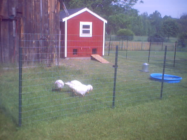

Last week there were 4.
We were at the Agway & I felt guilty so we picked up their last 3 peking ducks & 2 leghorns.
If I had known she was going to have this many I would have built a bigger bird barn.
