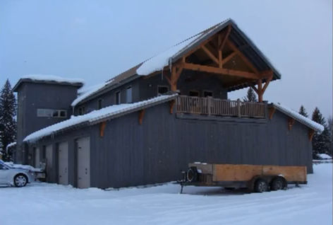

So here's a quick drawing of the basic layout. The frame will be 12/24/12 on the bents on the open end, with probably 10' bays. The two story side will be 12/8/8/8/12. The ground floor where the second story floor is doesn't need to be open and will have storage on the outsides and might end up wider before I'm done fleshing the whole thing out. It might make sense to have at least one side of it able to park cars in, but that's easy to figure out since the doors would only be 16' wide. Wider lean-to's would be stronger as well. I have all kinds of space, so I'm not worried about this getting too big. I also have plenty of trees.
Drawing not to scale. :eek:
I'd love to do something like this, but the balcony end would be exposed to our predominant winds and the floor sealing (water) would be a nightmare.
