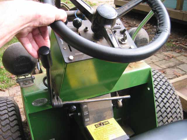

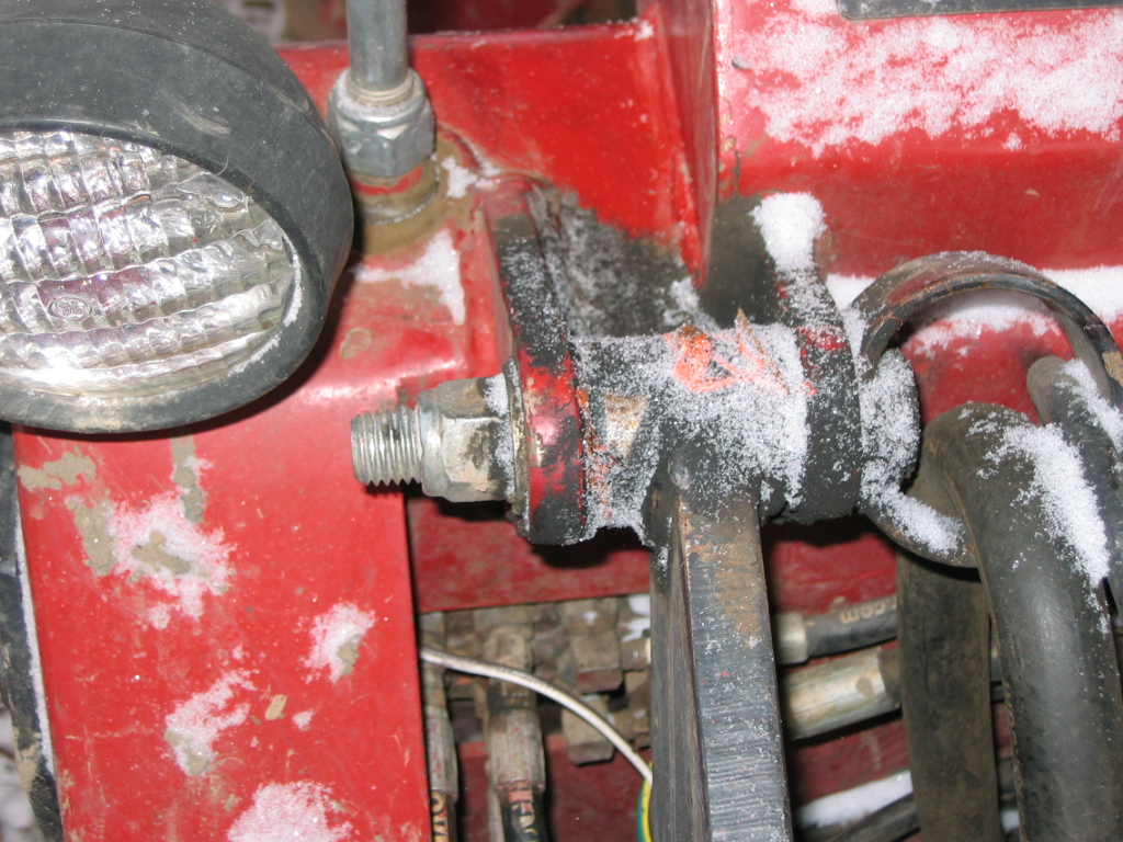

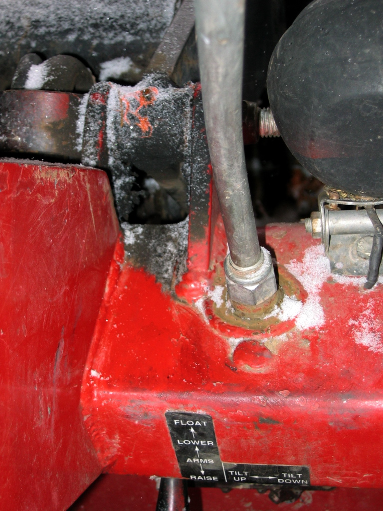

So, in the greatest form of flattery I was going to rip off KentT idea for a PTO lever.
Mods & Custom Builts
But as I looked over my PT, I realized that the hole I need to drill down is going to be right next to a flange that holds the lift arms.
So, a 1/2" hole is what I am thinking. Will I create a weakness that is going to impact that lift. I looked at Kents setup and he is a good 2" away.
In the photo, it would be between the console and the lift flange
Any thoughts?

I wouldn't do it. Not a 1/2" hole. To close to an arm support. The weld from the arm supports has already weakened the steel in that area. Having a hole there now in softer steel on a support arm area is not a good idea. Steel, probably cold rolled steel has its own temper, by heating it and allowing it to cool from the weld made it softer than the other steel in that area within several inches of the arm weld bracket. It probably isn't a big difference from the other steel but who knows how much carbon was in the steel in the first place. Carbon can make steel harder and also more brittle if heat treated. Either way it could be a bad thing to do. Then again it may never hurt anything either but I wouldn't drill there.

PT doesn't seem to have any problem drilling holes near the pivot flanges. There are two holes for each headlight on the PT-425.

I agree that this is the approach I'd take, given the location of that lift arm bracket. Looks like the linkage to connect to the valbe body control on the right side is a bit more complicated, but it doesn't weaken anything...

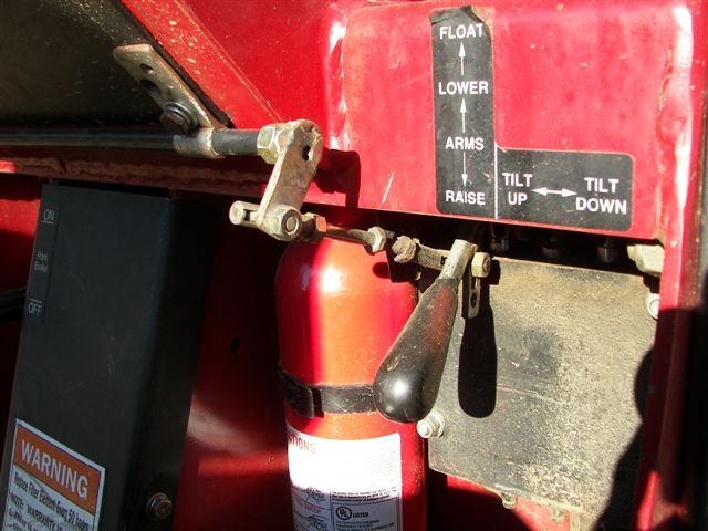

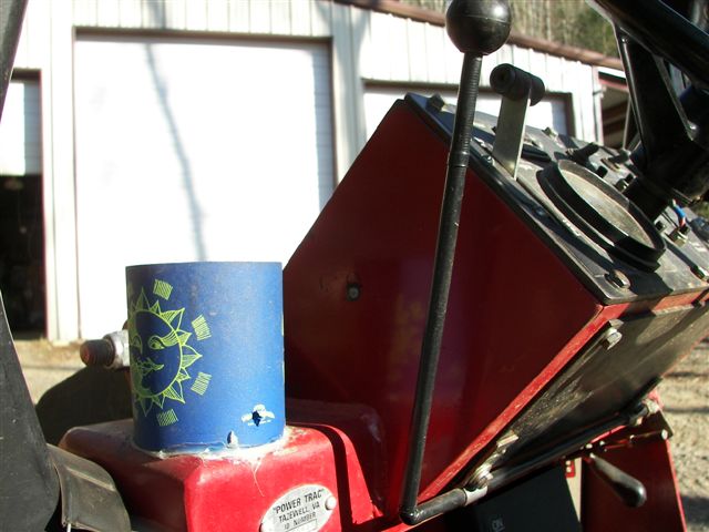

Well here is something similar I was talking about. The first one is not the picture I wanted because the one I wanted was on the red style of PT. This is from mckat, it was connected very much the same but the strap was in a different location. The pictures of the red PT are the ones I was talking about and their from DonStillwagon from the post "Anyone have pictures of Quick Attach Handle Mods" on 3-18-2008. I hope this helps.
