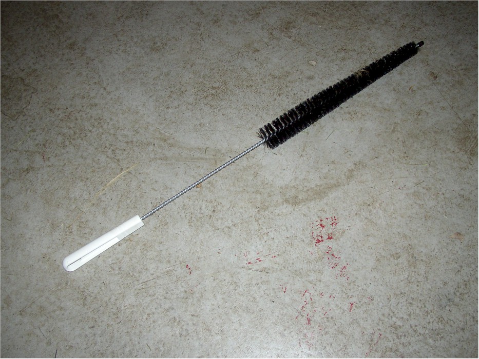

On many JD tractors there is a removable screen in front of the radiator that can/should be removed regularly and cleaned. However over time there is still debris that will get through or around the screen and attach to the radiator. With the screen removed you can see the debris down the screen slot but other than shooting some air (at a vertical angle) down there it is really hard to get to. Poking a tool down there risks damaging the radiator fins. I found a Fuller Brush (remember them?) sold at Lowes that is designed for cleaning the vent at the front of a clothes dryer where the filter sits works great. The bristles are designed to do no harm while somehow really grabbing all the dead grass and dandelion seeds from the radiator.

Thanks for the tip about that Fuller Brush, JD755!
