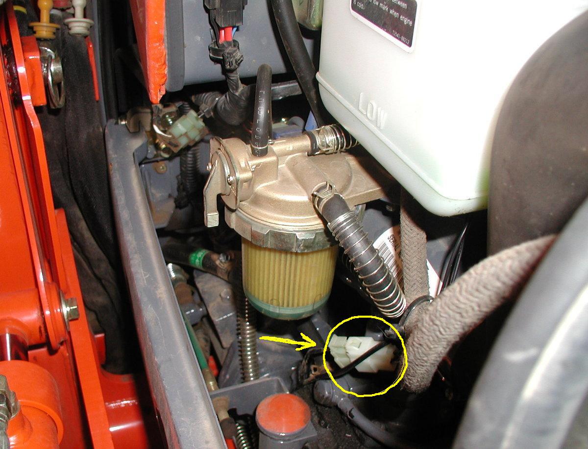

My engine temperature sensor gauge on the dash has stopped registering engine heat. The connection is tight from the thermostat housing, so is there another place to look to fix it?

Yes it is helping I'm just slow to pick it up. On this '07 CK30HST, I'm looking at the right/rear engine head (looking from the drivers' seat) where the cluster of wiring and fuel lines is. (Not the exhaust collector tube side where I do see an engine hoist bracket but no wires are around it.) I'll have to look harder because I don't see the thick glow plug wire or the real coolant sensor wire going to the dash gauge. Could you point out in this picture which it is? If I'm even in the right location, it's a maze.

you sir are getting warm... for me to remove the temp sender and or the bracket the lifts the engine..... I have to remove the fuell filter bracket, and it is still a tight fight. this temp sender / glo wire / bracket will be on the right rear of the head.... kinda under the fuel tank.... it is way on back there next to #3 injector... I will try to post a picture.

I rec'd the picture Virgil thanks. I see why you had to remove the fuel filter housing, etc, to get to it behind the fuel lines and everything under that "shelf" in the firewall. That is a hellish place to try and work. Fortunately, I guess, my Engine Temp Sensor Wire is not pinched between the firewall and engine hoist bracket. So it must be down to a broken gauge, glad it's under warranty :)
Here's a post of the picture:

I installed a new temperature gauge in the dash, under warranty. It still doesn't register engine heat so the temp sender on top of the engine is the culprit and has to be replaced. The dealer was fast and sent the whole instrument cluster, it's a unit.

My CK30 temp gage does the "work-no-work" thing every now and then, all I do is wiggle the wires at the connector (circled in pic) and it reads right! Try it when you know it is warm with the key on.
