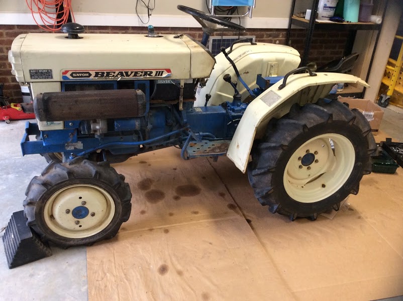

I have a Satoh Beaver 373D. Mine came with the 3-cylinder Mitsubishi engine. While doing some tree pulling and brush cleanup in the woods my oil dipstick got pulled out. It is lost and I need a replacement. If possible, could one of you guys send me a photo of the dipstick lined up with a ruler so that I will know the proper length and hash marks on the stick? It would be greatly appreciated. Thanks

The dealership is not available since it is a 1974 Satoh Beaver 3 tractor. The dealer it came from is out of business.
Made me one and cut it to about the right length. Use the current oil level in the tractor to mark it.
It will do for now.

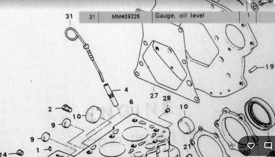

A google search of the part number finds one in the US for $14. Might want to search the pn for better local options.
