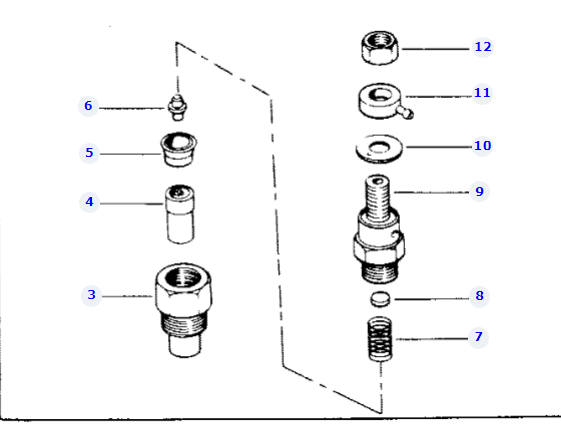

fuel is not getting through injectors but is receiving and I'm trying to take apart the injectors but even with a vise i have no luck to
take apart, any advice i can take fuel injectors off?

Loosen the lines AT THE INJECTORS and spin the engine.. watch for fuel to squirt out of the loosened lines..THAT will tell u if u have fuel TO the injectors..
If u wanna go a step further, pull an injector and hook it back up to the line outside of the engine and spin the engine to see if it’s popping the injector..

The injectors are not getting fuel past them but its getting fuel to it, so I'm trying to clean them at the moment
