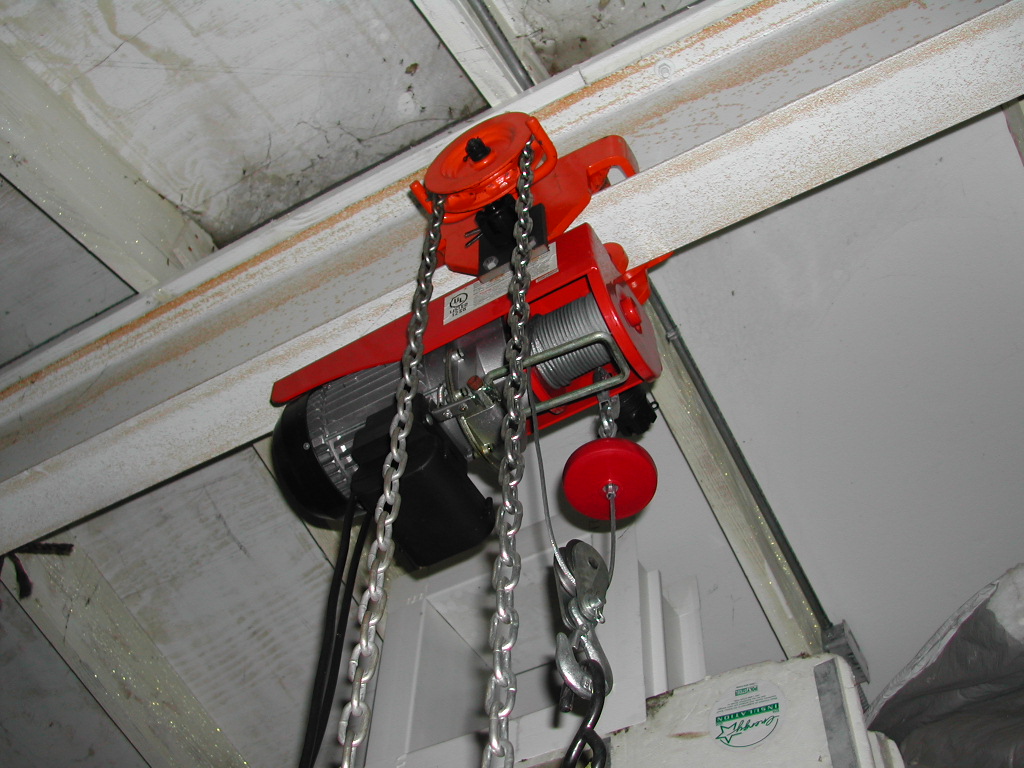

I know a mechanic who installed a steel beam in his ceiling, supported by steel posts, and that works well.
I designed and built my workshop with a steel ridge beam. I upsized it
a bit and ran the calcs to anticipate an additional 1/2T load at the
center of the span of 24 feet. I used the HF 900# hoist with their rolling
trolley. It works extremely well for engines, splitting tractors, etc. I
have never felt that I needed more capacity either. You can buy the
HF 1300# hoist for less than $150.
The cost of the beam? Actually less than wood beams of equivalent
strength.
I would consider retrofitting your shop with an I-beam and 2 columns at
each side of the span, attached to the walls.
