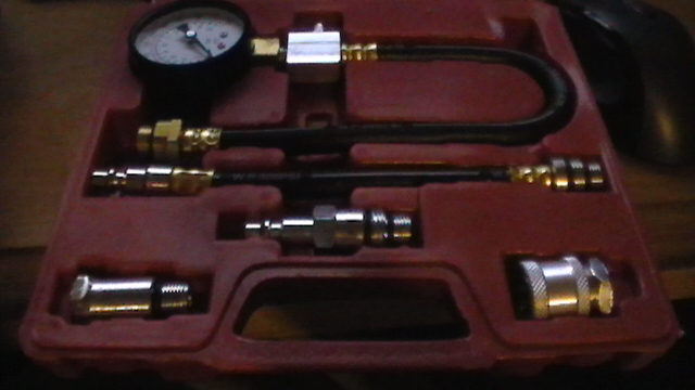

compression test kit order
   / engine knock / clatter
compression kit arrived today. hoping next day or 2 get to the tractor and test things out.
