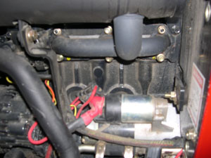

Hey all. Looking for an engine heater. I’ve seen the posts on a freeze plug block heater, but the freeze plug on my DX-33 looks to be a pain to get to. So, I got to thinking about a radiator hose heater like on my older tractors. Has anyone installed one of these on their 33 or 29 tractors? I’m asking because I want to know what size to order BEFORE I take the hose off. I’m afraid if I take the hose off to measure the inside diameter, what ever I try to order will be out of stock. Thanks for any replies.

Best I can tell is the hose is about 1 ¾”. I was thinking the heater went into the lower radiator hose for better heating capabilities.

I just installed a freez plug heater no big thing. took about 1hour. works great. the problem with the circ kind is you will want it low to the engine block. I could not find any place that would work well and not expose it to damage down the road. found the freez plug just installs alot cleaner. we have had below 0' weather for about 2wks and our tc33da stared every time.Good luck. did the install with fel in place. drained the block. punch freez plug into block. fish it out . install freez plug at the 7:00 OCLOCK Pos tighten up. refill block and plug cord in. Done. got my freez plug at dealer for around 45.00. good luck. /forums/images/graemlins/cool.gif

I must be looking at it wrong. It looked like the starter and some wiring had to be moved. There doesn’t seem to be that much room behind the starter to get the plug out, much less to install a heater.
   / Engine Heater for TC33 #6
No need to move anything.

I have a class II, with a block heater. It's in the same location. There's nothing in the way of installing the block heater.

On mine, the starter is definitely in the way. Just look at the attachment. The back plug doesn’t even look like it has room for a heater.
