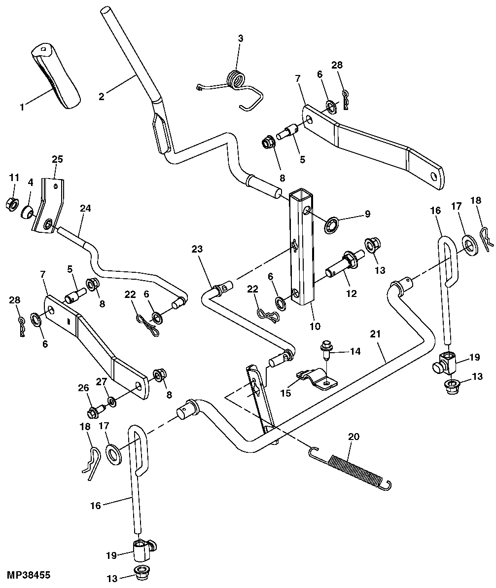

John Deere - Parts Catalog
This is a parts list and dealer prices and maybe you can isolate an area in the picture that stops you from going left of center(?). If this is unfamiliar I will look at mine and submit a photo tomorrow of my guess.
I think it maybe part on the body that the deck lever (#2) locks into.

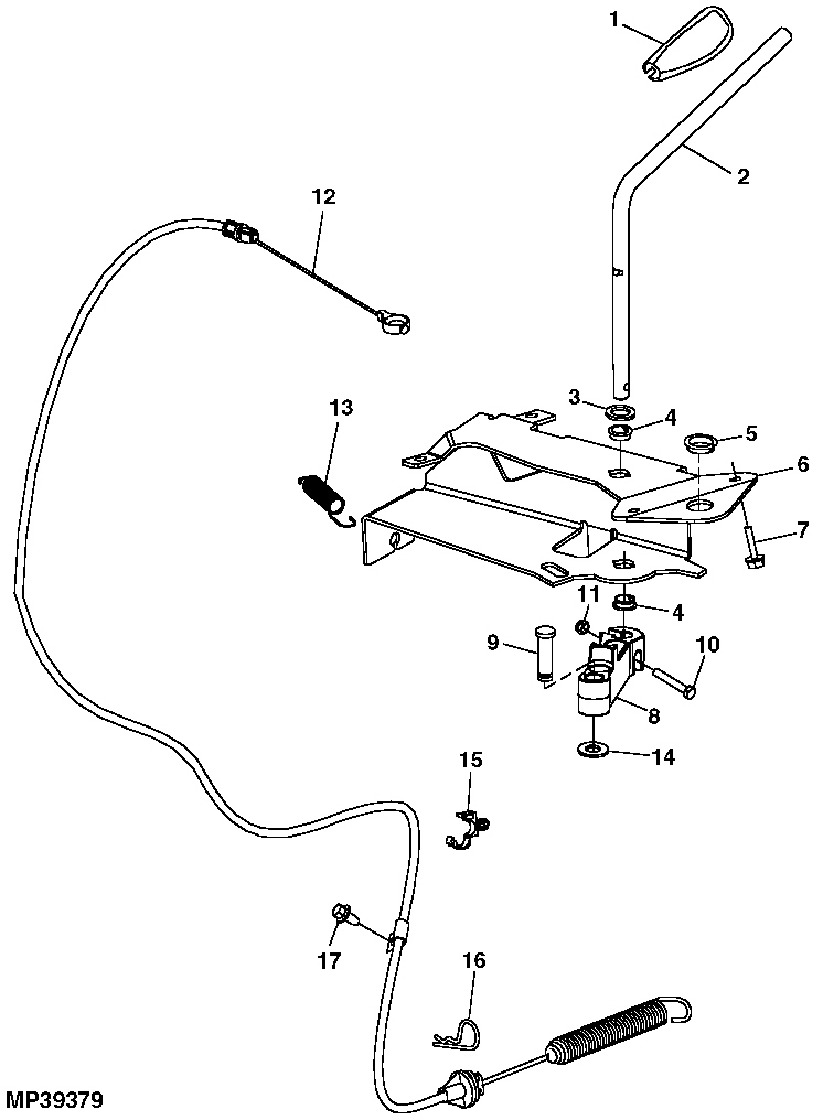

Better Understanding today. The engagement lever.
8 - GX21041 LEVER 1 (A) (SUB FOR GX22488)
Part Number:
GX21041
Part Price: 5.07 USD
   / engagement lever over extended
Part Number:
GX21041
The number 8 is the part... for that price I will buy two or three. :)
Thank you so much!!!
Marcia
