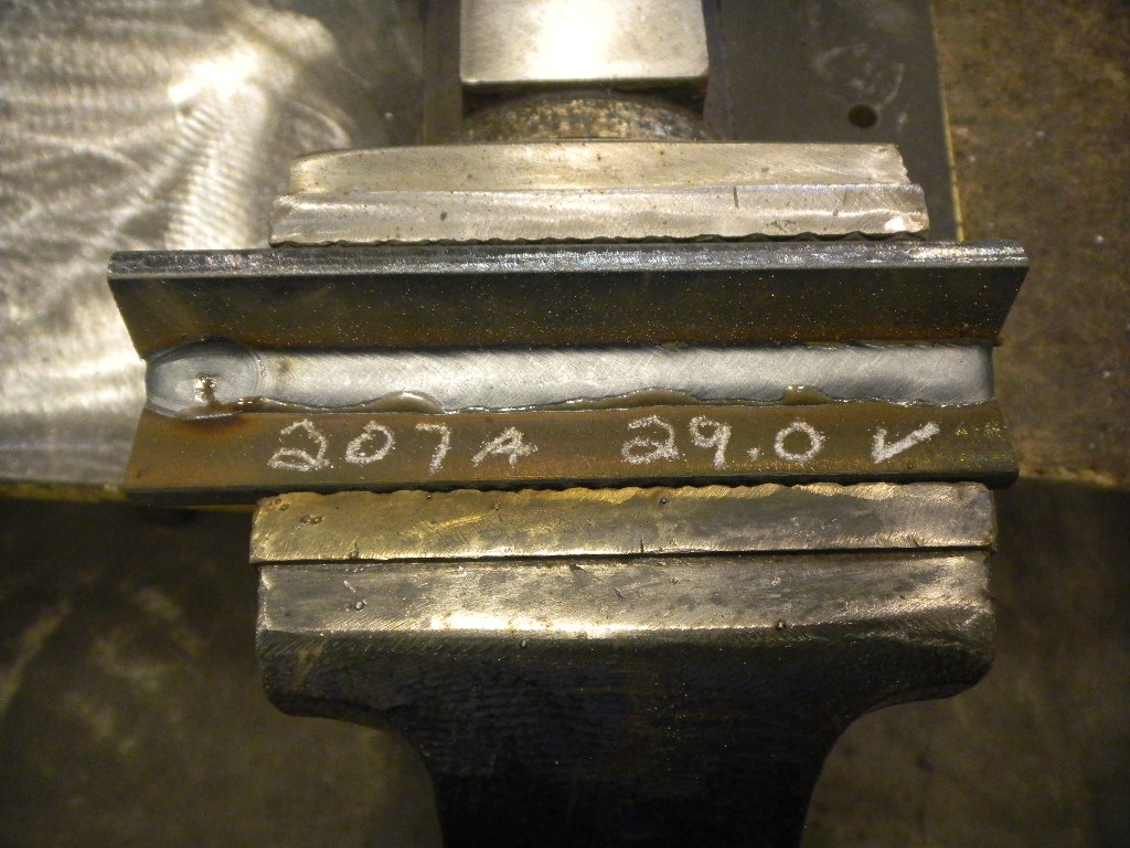

What I try to do when ending a weld. Now that's not including the times when I will continue the bead, but stopping all together. I turn the rod or gun more to a 90-degree angle to the plate, and backup 3/8 to 1/2-inch, and let the puddle fill.
Look at this spray arc weld, see how the puddle is almost full? And see how far back the puddle is? Now take note, this weld was run screaming hot! 207-amps on 1/4-inch plate is HOT!

What SA said. Back up over the end of the weld a short bit and pause very briefly. It adds a bit more filler to the stop to prevent the crater.
