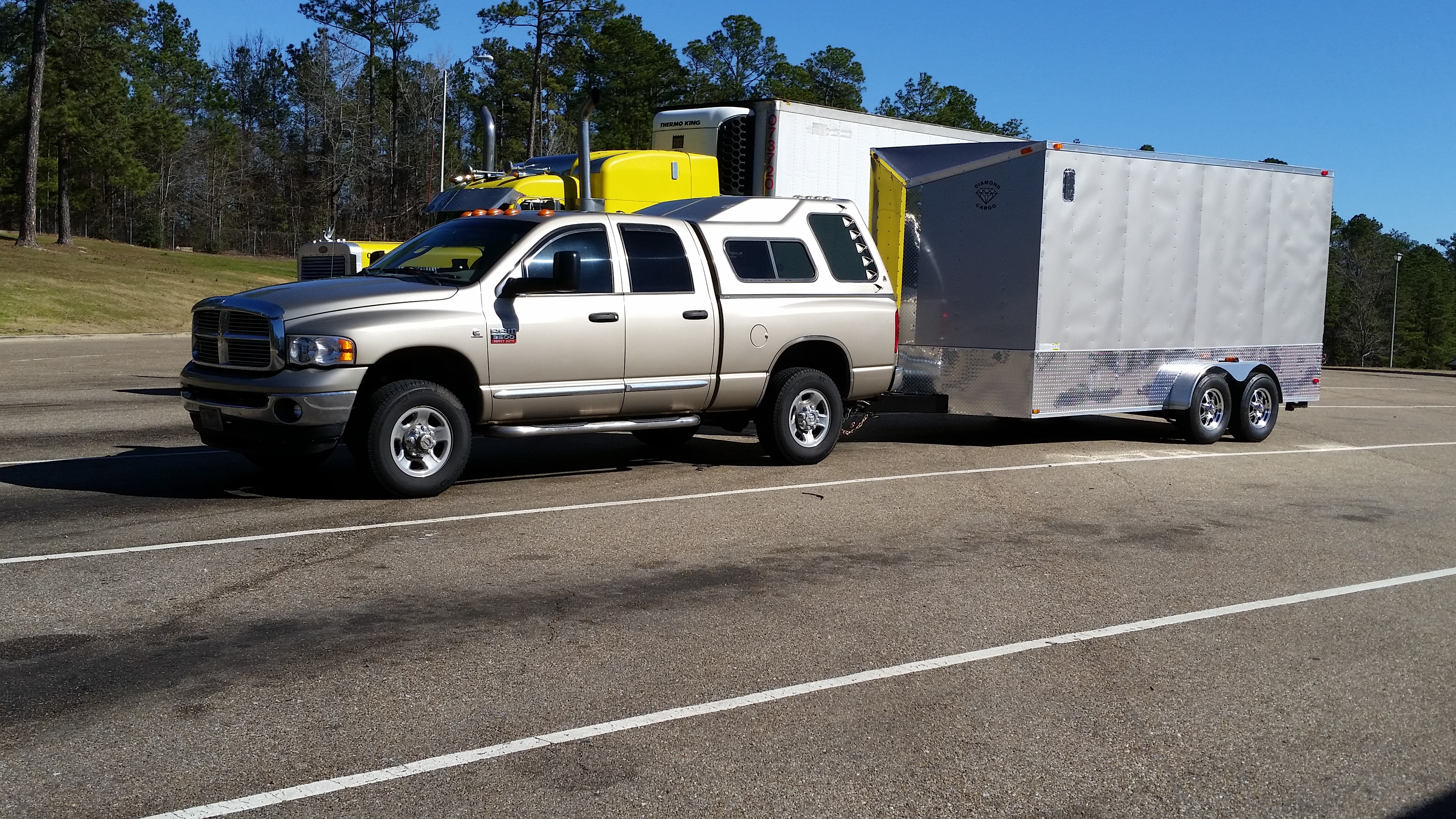

   / Enclosed Trailers for Sid Steers and Compact Tractors - do they make them #5
I had a trailer made to certain weight requirements. As an example floor supports are 16 inches on center. Ramp designed to handle 4500 pounds. Tie down D rings rated for 5000 pounds each.
Door opening height clearance of 84 inches. Trailer width of 7 feet.
   / Enclosed Trailers for Sid Steers and Compact Tractors - do they make them #6
Is the ramp designed to take 4500 pounds in the middle of it or a 4500 pound vehicle?
#9
War Eagle 2
Nice looking trailer. I will check with closer floor spacing and the added strength ramp door.
Thanks
