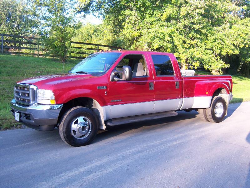

What are you pulling it with?<snip>
A Ford F350 7.3 dually
attachment.php
571175d1537122926-enclosed-trailer-v-front-worth-101_0019-jpg
You will notice a little savings with MPG's, not much but you won't know it's behind you with the old 7.3 dually.. I pulled a 20ft V-nose for a few years with my tuned 7.3, it pulled nicely..
