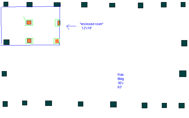

I have a 36'x63'pole bldg ( built in 1981 ) "Floor" is Cl 5 gravel over 4" to 6" heavies. Location---> WI
I want to make an enclosed room in one corner 12'x18' with a 4 to 5 inch poured conc slab.
At the moment , there is a storage loft in that corner (to remain)
The question I have is should the two new walls that are to be made rest on the slab or should three new posts be buried to the same level as the outer wall posts?
I'm speculating that the slab should "float" and the posts should carry the walls.

I have 2 Morton buildings, both with interior rooms. One of them have the walls sitting on the slab, one has poles supporting the walls. Neither of them have gave me any problems. The one with the walls sitting on the slab is 15 years old, and that is how I would do it if I did it again.

on the slab, would be advised. granted it is assuming you have good "drainage" and min frost heave already. gutters help great amount, and then making sure land around shed/barn slopes away from it.
drilling a hole and dropping a post in the ground, if not correctly compacted, could lead to water buildup, causing the slab shift more. granted it would be inside the building. but moisture, etc... will find its way to the low spot and frost heave. all the other posts (around outside) been there for years and is as compacted as it will get.

My next question deals with the four loft supporting posts ( in red in the not quite to scale enclosed diagram) The pole bldg posts are in black.
Should a separate pad (footing) be made for each "red" post prior to pouring the floor for the "room' and isolating it from the poured slab with "sliip forms"?
Will try to post diagram.http://i994.photobucket.com/albums/af61/GitcheGumeeKid/Project/EnclosedRoomProject_zps2984efc5.png
GGK
What size should the pads be? How thick ? Below the frost line?

What are you putting in the loft? I would probably do conventional stud walls, double top plate and appropriately sized 2xjoists stacked over the studs covered with 3/4" plywood, no posts in the middle of the new room. If you are saying you have existing posts to work around supporting an existing loft that is another discussion. I would install the slab and conventional pressure treated floor plate, studs and finish as desired. I did this between existing post in our pole barn. No frost heaves to speak of where I live though.

^^^^This is what I am saying.

X2. JimRB. That is what I would do. I learned a lot working for my buddy's dad. A contractor for 40+years. Keep us up to date on progress.
