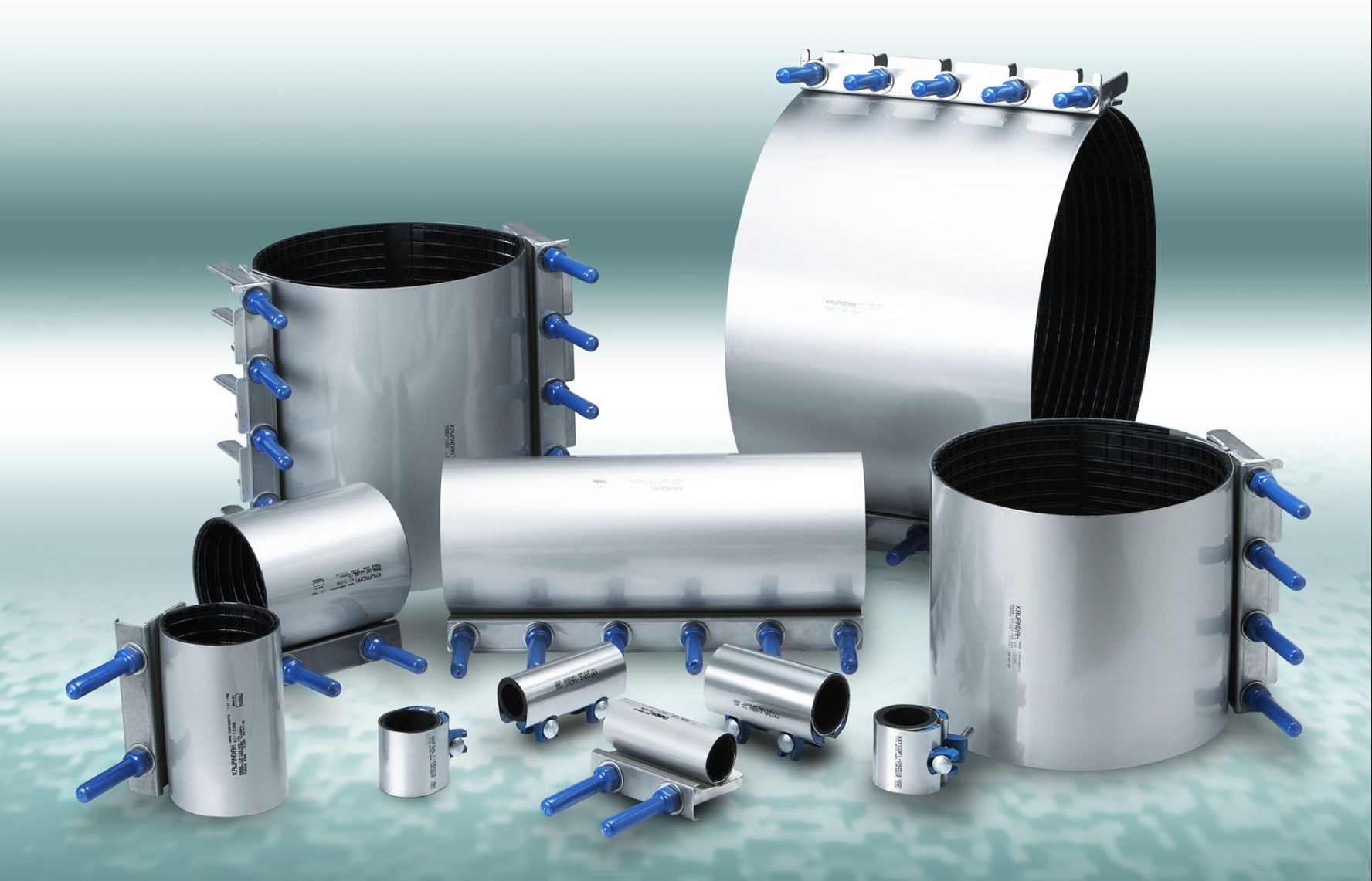

Would a clamp like in the attached picture work?
:confused:
:confused:
The drip is on the bottom of the pipe, between two couplings. It may be two drips and I'm going to have to take a mirror with me. The pipe is barely off the floor, so I can't do there to see for a direct view. I may pick up a couple of clamps while I'm in town.
Thanks for all the suggestions. I'll let you know what I'm able to accomplish.
