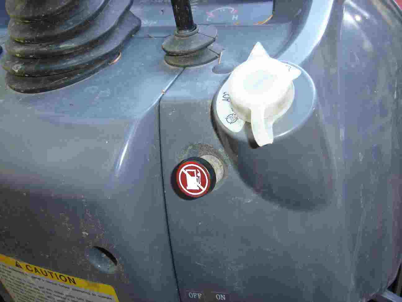

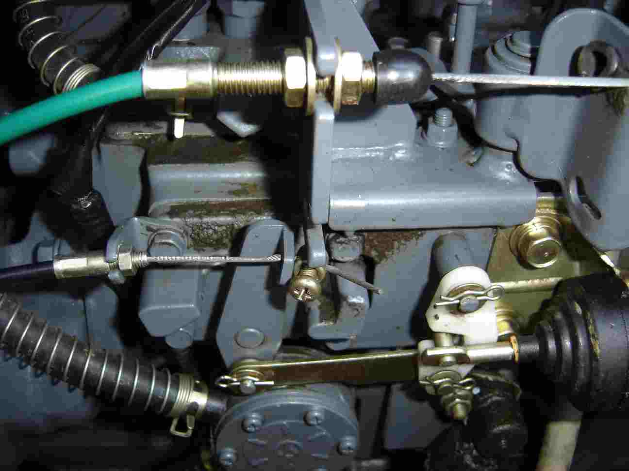

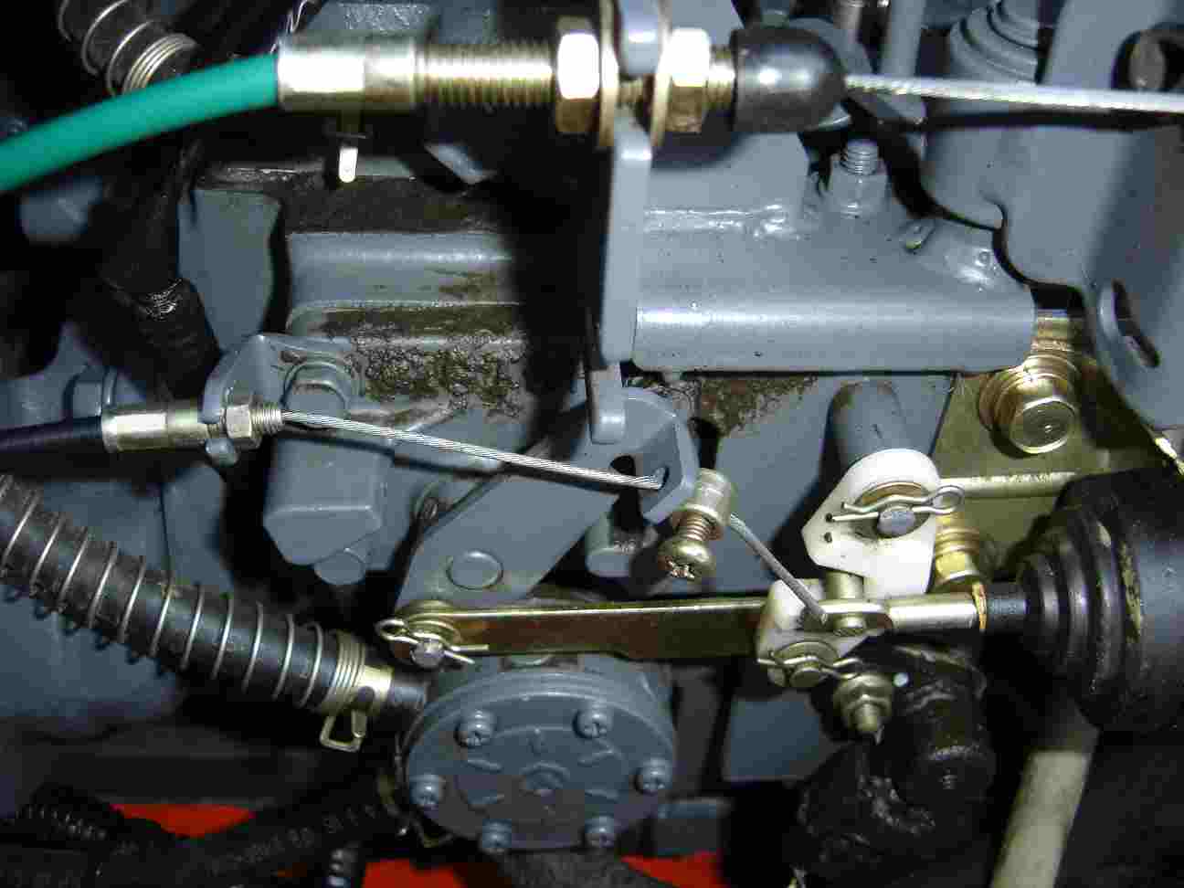

I've got one! I thought I did but I didn't want to say until I made sure. I used it when I first got the tractor to make sure it worked. On my old Case 580c that was the only way I could shut it off. If I didn't have one I was going to install it. My neighbor has a Kubota BX22 that had the shutoff solenoid stuck in the off position. It took us a while to figure out the problem but we muddled through. It seems that it just as easily could have stuck in the on position. When we had the solenoid off and testing it I started the tractor. When my neighbor told me to turn it off I tried with the key but of course that did not work because he was holding the solenoid in his hand. When he put the solenoid extended pin back in the hole on the fuel injector pump thingy it turned right off. The point is that these electrical shutoffs fail on occasion. If it is at a critical moment when things are going south it is nice to know that no matter what is happening I can turn the engine off. Here are the pictures of the shutoff on my CK30. The second picture #12 is with the nob pulled in the off position. The third picture #13 is with the knob pushed in the run position. Its the black sheathed cable on the bottom. The green sheathed cable is the throttle.
On a side note this is the first time I have taken the side panel off. I was pleasantly surprised at how easy it is and of the engineering that went into fastening the panel.

Thanks for the pics Twig, food for thought.......... and maybe future project.

my may 05 has one...maybe one could be retrofited on later ones if a lever exists on injection pump?

I would think the cable could be ordered off an earlier one if the lever exists on the injection pump as shown in photos above

I have the shut off knob, (2005 CK30), but maybe someone could post a picture from the same (twig's pic) area that doesn't have the knob so those interested can see what would be needed to add the manual shut off. Perhaps the addition of parts would be minimal.
