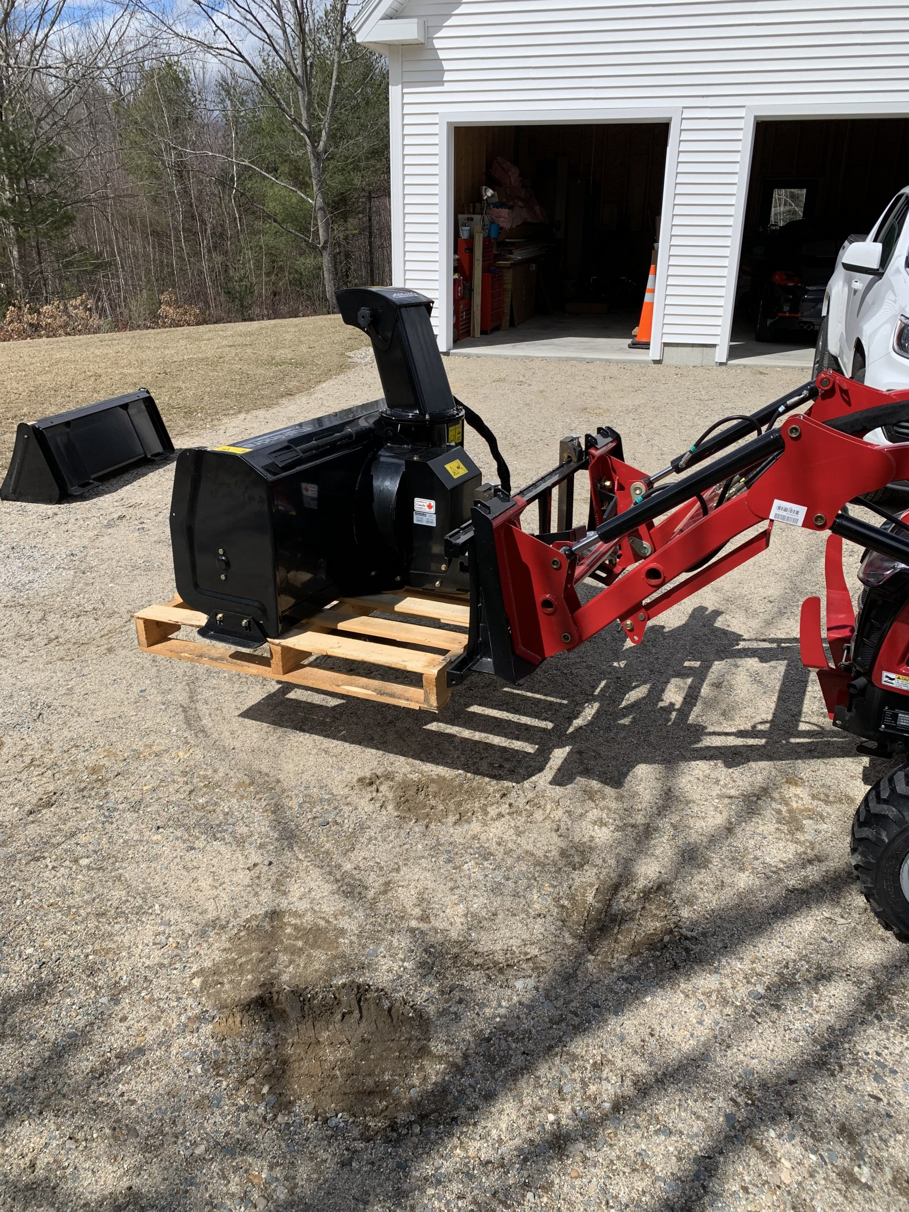

I ended up purchasing the HLA pallet forks for sub compact tractors.
42” forks with a 900lb 21” load center ssqa

Hello. Can you be more specific as to the exact set of forks you purchased? What you have in the photo is what I am looking for. Is there another attachment needed for the quick attach?
   / Emax20S pallet forks
My emax20s has the SSQA set up and the Pallet forks attach the same way the bucket does nothing is needed
