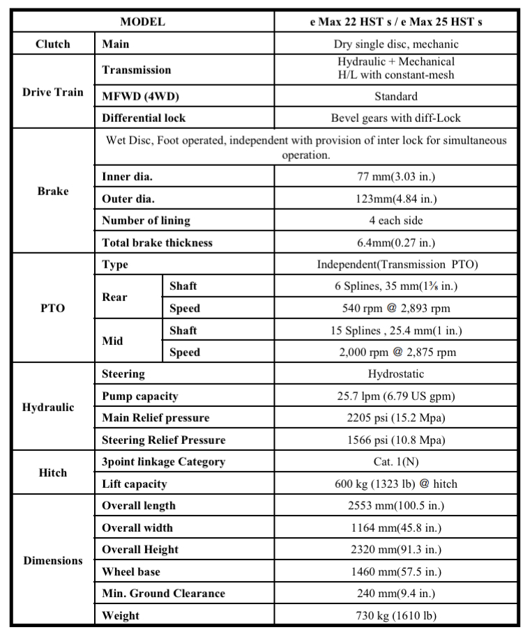

What is the recommendation on RPM when using a Belly Mower? I found info that contradicts what I was originally told. Just curious as to what everyone here recommends. Thanks
   / eMax 25: What RPM when mowing #2
PTO RPM. That's where your powerband is on the engine. I only run mine slower if I'm worried about throwing a stone or something or am in relatively short/thin grass.
Ok, dumb question then. What does PTO RPM mean?
   / eMax 25: What RPM when mowing #4
PTO RPM is the RPM the engine needs to run for the PTO to turn at the standard 540 RPM. On my tractor it's at about 3000 engine RPM. There is a mark on the tachometer on my dash at that point that says 540. If your gauge doesn't have a mark, your manual should tell you.
Thanks, I値l check the manual to see what it says for the eMax25.
Looks like 2875 for mowing. Thanks again
   / eMax 25: What RPM when mowing #7
My Mahindra has a little gear on the tachometer where PTO RPM is.
I’m surprised the RPM is almost 3000. I guess the little engine in your machine likes to rev. A lot of diesels redline at 3000 RPM and PTO speed is lower- like 2200 RPM.
#9
Seems high to me too, but runs good at that RPM
   / eMax 25: What RPM when mowing #10
I don't engage my mower (or anything else) at that speed though. I drop to 2K or so, engage, then ramp up.
