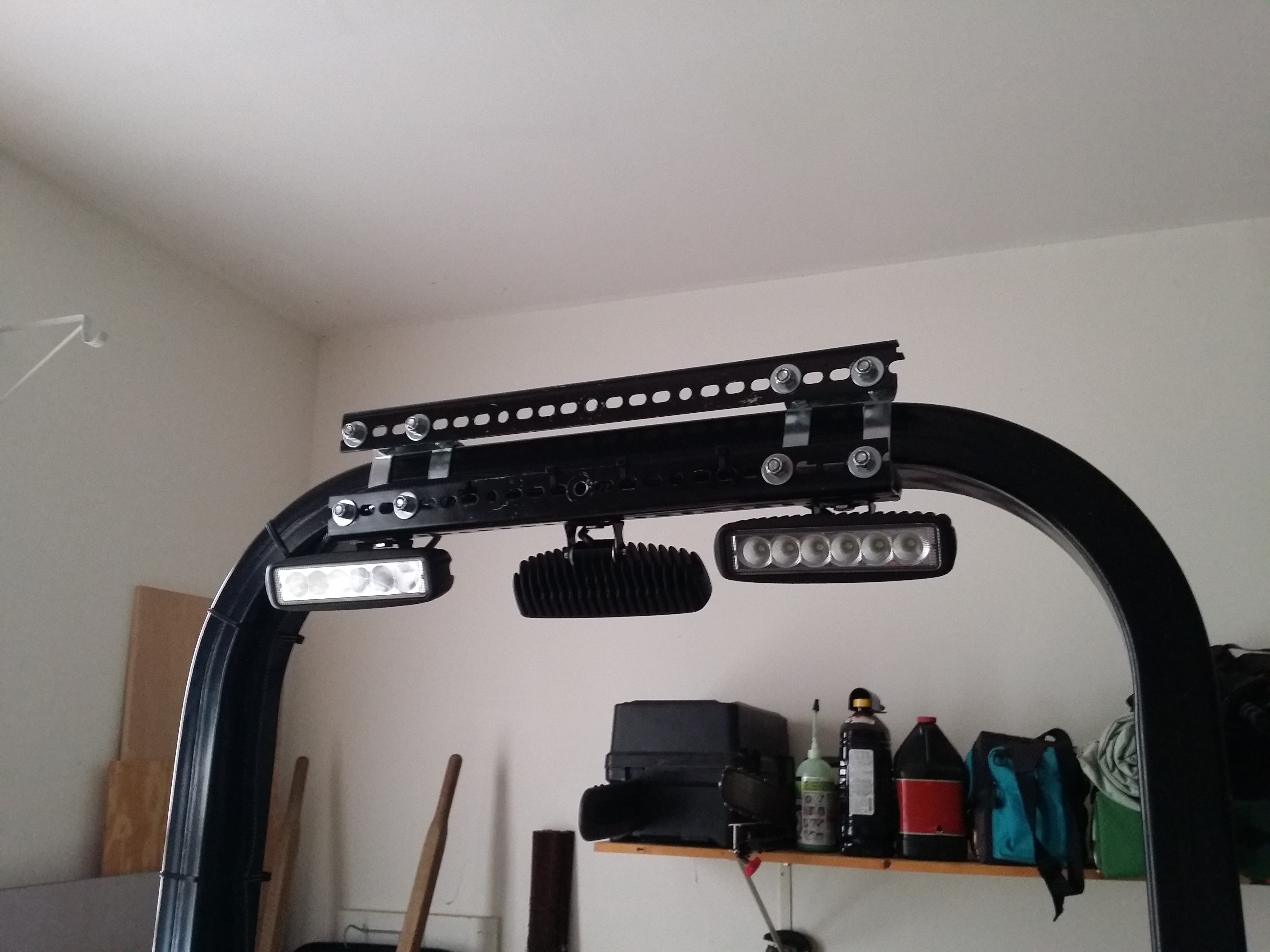

   / eMax 25 rear work light #5
I have two rear facing pods, 1 facing down for the hitch and one facing further back so I can see what I am working. I also have a full light bar facing forward.

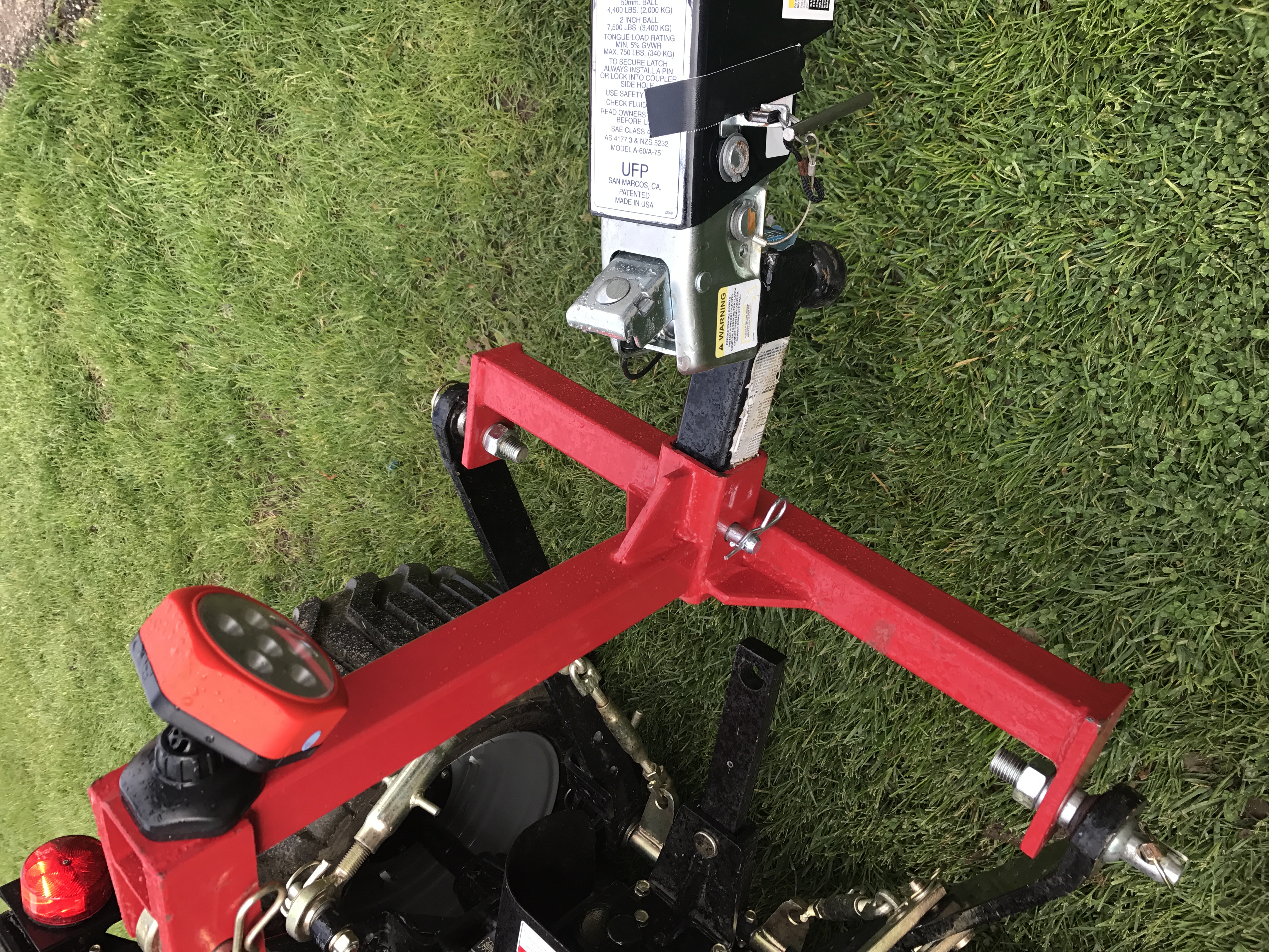

#9
Found the easy/cheap solution today. All I need it for is hooking up trailers on the back of the barns where it's dark, so this magnetic light looks like it will work fine. I picked one up today to try it out tomorrow.
Rotating Magnetic LED Worklight
