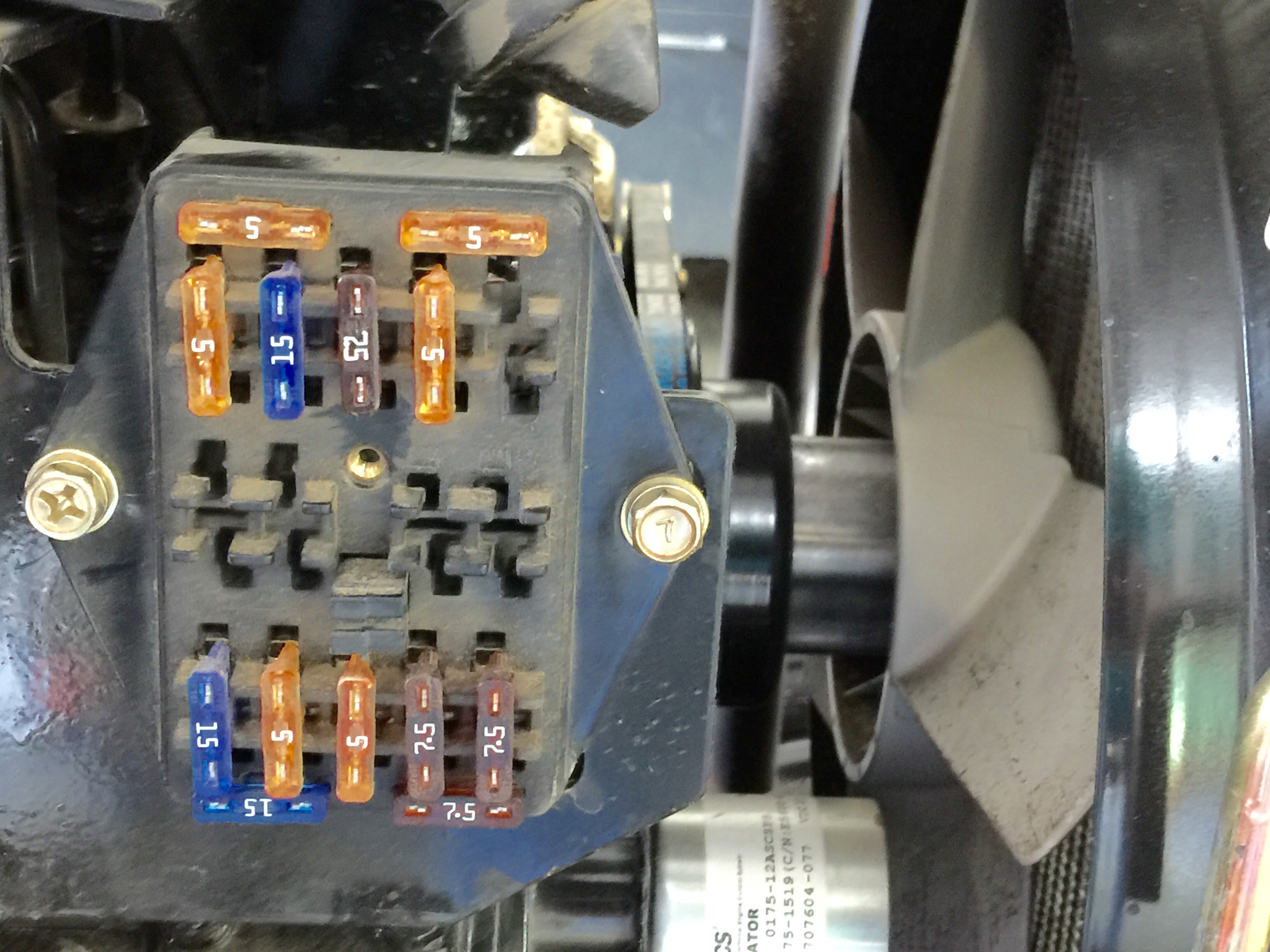

Greetings again everyone,
My dad had his eMax 25 HST tractor picked up yesterday by the dealership. The mechanic(s) checked it out and found a corroded terminal somewhere around the right fender area that leads to the rear/mid PTO on the tractor. If I understand it correctly the terminal created some extra resistance in the wire/circuit and caused the 7.5 amp fuse for the PTO to blow. They cleaned up the terminal (connection) and replaced the blow fuse. We got the tractor back today. I tried the deck out and it started up fine. It was a simple, no cost fix thankfully. :)
Before having the dealership pick up the tractor my dad and I took the deck back off the tractor and reinstalled it to see if this would fix the problem. Of course this didn't fix a corroded terminal or blown fuse, but the PTO section level freed up and would shift back and forth with no problem.
Jabonee my dad and I were talking and trying to figure out how the terminal may have become so corroded even though the tractor is not really exposed to the elements. I told him that you said Mahindras and water don't mix. Dad brought it up, and I had forgotten that after he dad shovels snow that he always likes to wash the tractor off with the garden hose to get any salt and dirt off of the tractor before he puts back into the garage. So his washing of the tractor probably contributed to the terminal corroding. :duh: Also he learned after talking with the mechanic that the PTO "engage" light was staying on as an indicator that there was a problem with the PTO (or the circuit).
And for any eMax owners out there that are not sure where the fuse box is; it is the black plastic box on the right hand side of the engine about 2 to 3 inches behind the radiator fan. You have to take the right side panel off of the tractor to access it. Below is a picture of the fuse box in our tractor.
