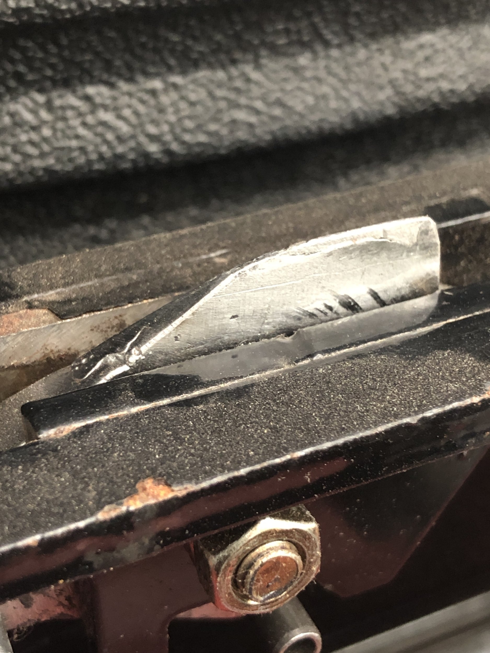

I had the same problem on my Emax20s
My problem was similar to yours but it’s not just the fact that the back latch wasn’t latched it was the metal latch only went up into the seat catch by like 1/16”
Any leaning back the latch would separate and the seat would slam dow and get wedged... which I would need to break out the flat bar and pry up to free the seat.
My fix was to remove the latch, weld on some additional 1/8” material at the top of the latch and grind back into shape.
So far no more seat failures.

Attached is a picture of my not so professional weld on the seat latch for reference
