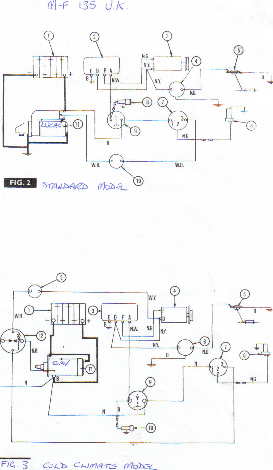

Massey Ferguson 135
Does anyone have (or know where I can get) a wiring diagram for a 135 Massey Ferguson? I am doing a partial restore on one and the harness is in awful shape.
Help.

I don't know if there is a difference between the UK and the US model. Could I take a look at your schematic to see if I may use it?

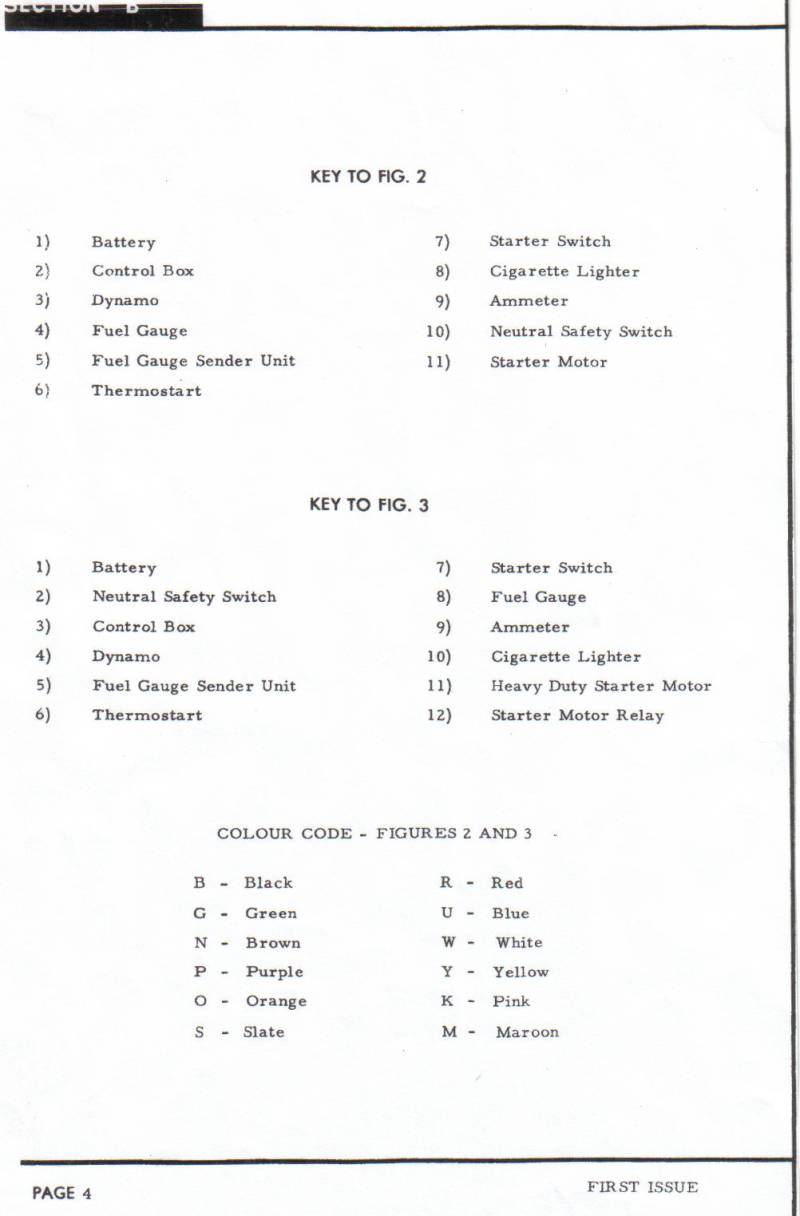

Here ya go Phillip, ignore the Cold Climate one, MF installed a number of
slightly different regulators over the years so your terminals may be in
another order.
