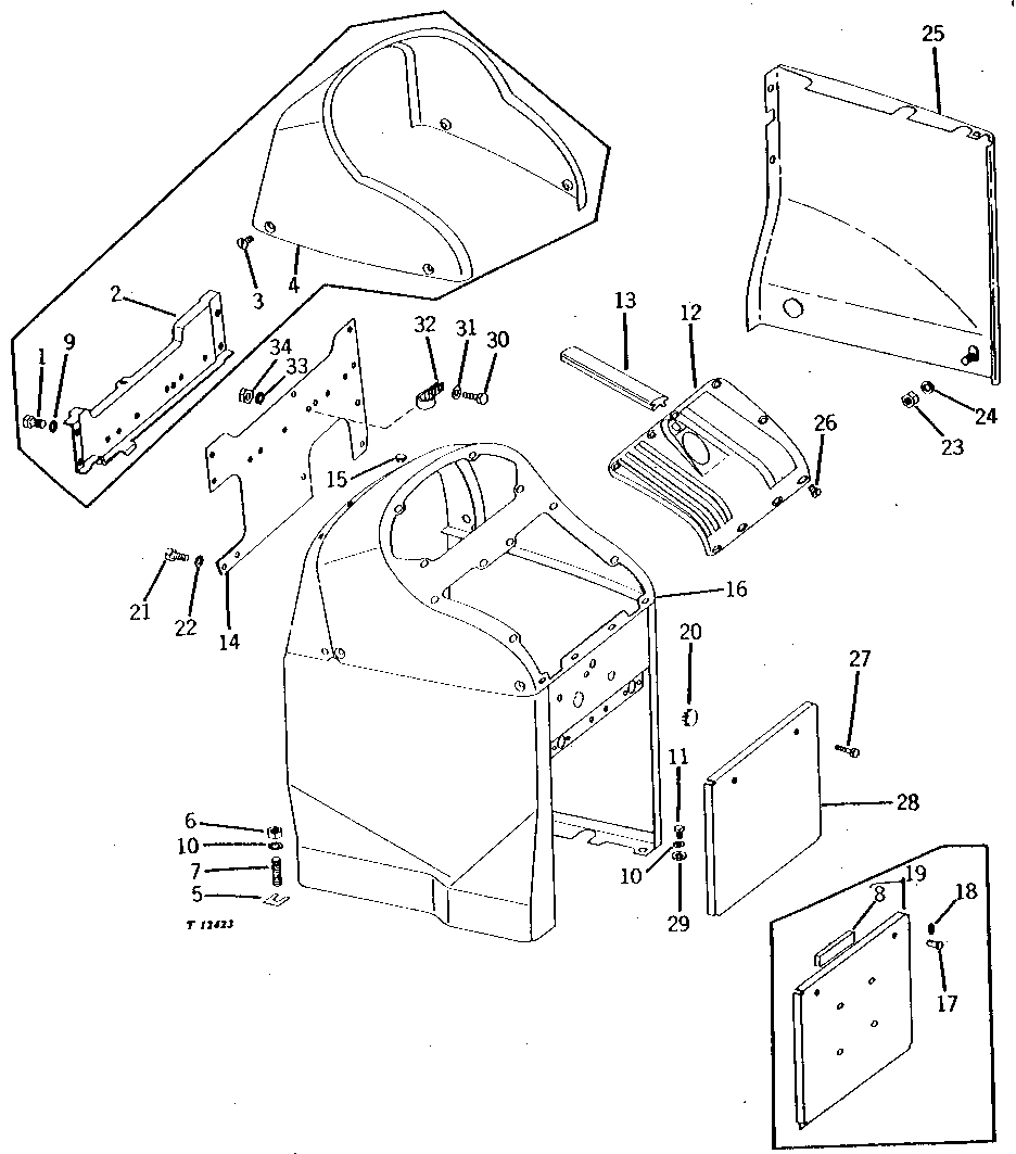

Have you looked under the dash for the VR? You must remove cowling(parts key 4) to access VR

I have removed the cowling as well as the gas tank. And I did not see the VR. I will probably need to purchase a replacement VR, but I am not sure of there is a specific type needed.
