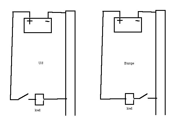

Hello everyone, I will use a general example of the light on a tractor. When you turn the light switch on, does the D/C current flow from the positive post in through the switch, through the light and into the frame, or does it come in through the frame first (negative post) then through the light to the switch?

1. Assuming the battery is negative post is "grounded" to the frame (let's call this 0 volts), we "think" of the current flowing from the (+12 VDC) positive post to the (0 V) negative post.
2. If the positive post was "grounded" to the frame, we would also "think" of the current flowing from the (O Vdc) positive post to the (-12 VDC) negative post.
However, where we "think" of the current flowing from positive to negative charged posts, the current, i.e. the electrons themselves are negative charges (remember from high school chemistry class where protons are +1 charge, electrons are -1 Elementary charge - Wikipedia, the free encyclopedia) , so I believe they actually flow to the positive terminal (i.e. opposites attract). But ignore this, and say current flows from positive to negative.
Why do you ask, cause it's really arbitrary how we "think" about it? Are you wondering which way to insert a diode?

for a simple "light" it doesn't matter ... but for some electronics , it is very important what gets connected to what ... ( try hooking up an alternator backwards or connecting 2 batteries up incorrectly) ...
Europeans follow the NEG ground now also, but "break or switch" the ground wire instead of the positive side.
   / Electrical question about the direction of D/C current flow #8
Like this? Any reason one is better than the other?
