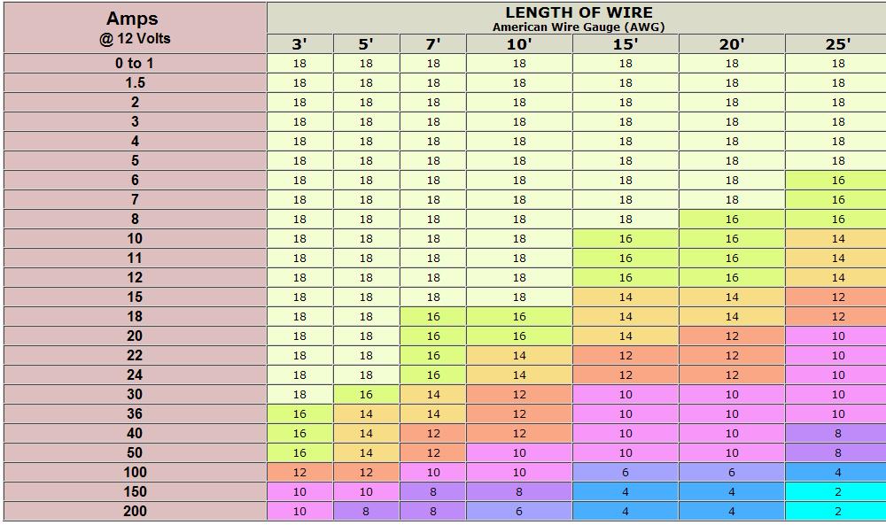

Any fuse must be sized for the wire it protects, stranded or solid. When in doubt as to gauge, look for 'xxAWG' printed on the insulation. Compare unmarked to marked of similar type/size.
Fusible links are good for service/towing biz. Never regretted replacing one with std wire & an in-line fuse holder ...
   / electrical problems please help #10
I've seen this chart all over but I have no idea where it originated from.
