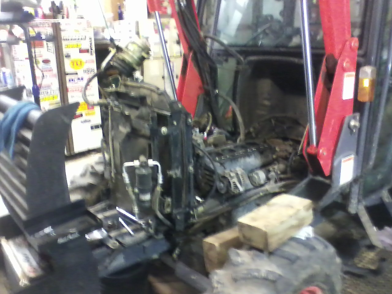

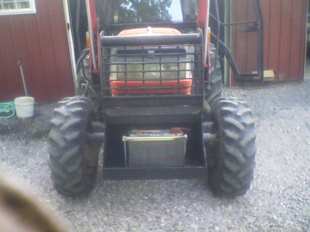

I still have the OEM battery in my 03 dk50C...no issues. I can tell it's slightly weaker than it used to be, but still cranks robustly. I did relocate my battery from crammed right up next to the condensor for the a/c, to out front inside a box @ the bottom of my home made grille guard....heat KILLS batteries, just shows up when you need the amperage ;)
Look to the far lower left of this pic, I THINK you can see the battery location
Kinda blurry, but it used to reside where the tools are laying in ft of cond...
added a 2nd pic...maybe it's better
