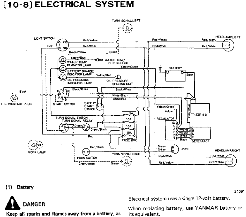

I had vandalisim done on my YANMAR FX 20D compact tractor;
they stole the generator + starter + current limiter + cutting many wires.
I have a parts book for the tractor into which i found a wiring diagram, but it is all written in japanese, even the wire colors are in japanese I think...
Is there anybody who would have a wiring diagram in english or french, for that tractor or would know where I could find one????

Search Bing and use a japanese translater dictionary there are a few available. Maybe able to translate somethings. For what it's worth I do have YM 2000 diagram I can post but probably would not be very useful. If a dealer or someone does have it I'm sure they will. Here it is anyways.
Carey

I have the F & FX Operation Manuals that have the wiring diagrams in engligh.
Danny
