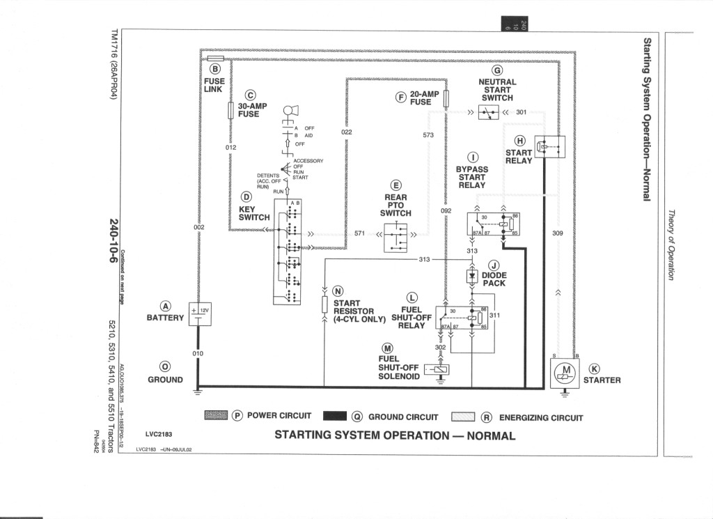

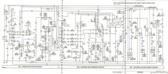

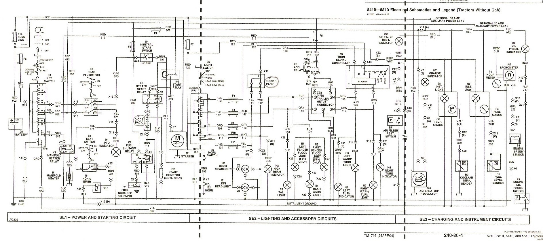

It is not the fusible link if it was everything would be died. I have included a link to the owners manual, it shows where the fusible link is located. I have attached the wiring diagram and the starting system. I would start with the easy things again. Check the 30 amp fuses. Not too many things to check, key switch, safety switches (PTO and in neutral), starter relay, bypass relay and starter/solenoid.

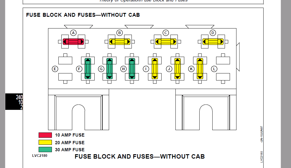

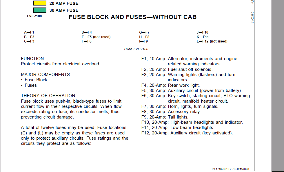

Well a bit of good and BAD news. I have found the pop was a fuse on the lower left. I had checked the fuses twice before and have no clue how I missed this but I did. Bad news, it is Christmas and I have no 30 am fuses so going to see if I can find a Walmart open close by. Not sure why it is blowing, but need to get the 30 amp fuse it it as specs call for as opposed to the 20 that is there now.
Next thing, am I clear with my reading of the lower left fuse needing to be a 30 a? And any thoughts what might be blowing this particular fuse?

Well a bit of good and BAD news. I have found the pop was a fuse on the lower left. need to get the 30 amp fuse it it as specs call for as opposed to the 20 that is there now.
View attachment 584417[
ATTACH=CONFIG]584418[/ATTACH]
Glad you found it. Getting correct fuse may take care of it (yes,slot F is 30 amp). If the new 30 amp blow's (immediately or within a few days)post back to this thread so that history is available. There's a simple procedure to nail down ongoing fuse blowing but no need to go there yet. Good luck and Merry Christmas.
