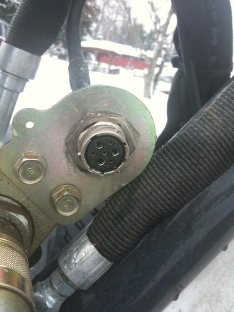

I lost the cap that goes over the 7-pin attachment controller connector and Bobcat want $52 (plus tax) for a new one. Any suggestions for sourcing another. I asked for a size and the parts rep said the descripion did not have any information. He did say that the caps are unique for Bobcat and that is why they are so expensive.
Thanks for the help and input.

You might try perusing the Newark Electronics or Mouser Electronics online electronics catalogs. They have a ton of stuff and once-upon-a-time I think I actually found the 7-pin connector. IIRC there's a brand name on the connector somewhere.

The connector comes from ITT Cannon and is in their Trident Neptune Connector line. The part number for the dust cap is 192990-0378. The cost is $3.14 each. Unfortunately they can only be ordered in quantities of 100 (according to the Newark Electric rep I talked with). Guess Bobcat had a little markup on this item.
For Craig, a picture of the 7-pin attachment recepticle is attached.

Group purchase. I'm in for 5.:)
