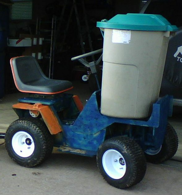

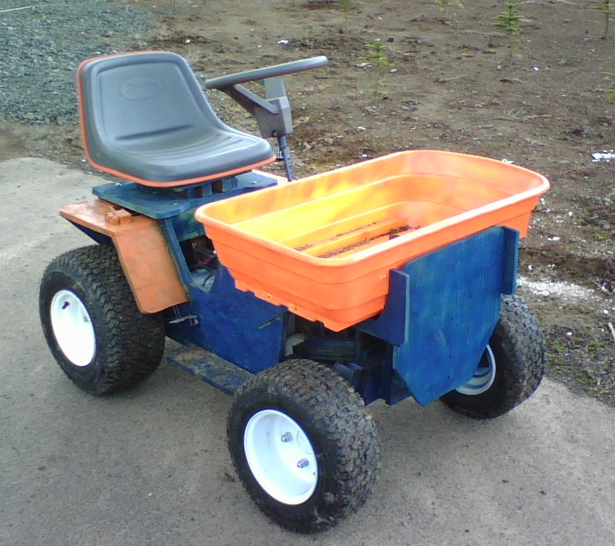

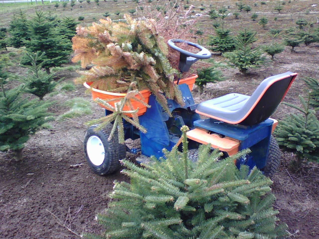

I finally completed my electric yard tractor project, built from plans as discussed in this prior thread:
http://www.tractorbynet.com/forums/build-yourself/113439-electric-tractor.html

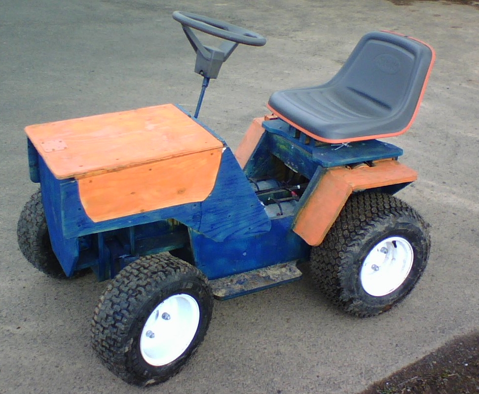

I think its gonna work out great as a all purpose vehicle on my small farm, great for hauling dirt, making multiple start and stop trips, etc. It doesn't take the place of my tractor, skid loader, or riding mower, but does replace an atv, golf cart, or other similar vehicle and, important to me, its narrow enough to go between the rows of my trees. Its geared down enough to have plenty of power, with a rated 2 hour run time. I modified it to have a removable hood, which I can replace with a dumper, or leave off to move a trash can 24V with four 38 amp batteries, running two 1000 watt motors (at 660 watts each at 24V). It should give me better drive traction than my mower, with both rear wheels powered separately.
The biggest downside is it was expensive: the controller alone was $450, another $200 for the motors, $200 for tires, $250 for batteries, it added up quickly...
But it was a fun project. Ian designed it to be built with no welding, mostly out of plywood, with some bolt together metal. I cheated and welded most of the metal parts, using a more traditional keyed axle setup.
Here's where I bought the plans:
Plans for 1300W Yard Tractor - Page 1.
Pictures of mine:

   / Electric yard tractor built from plans #10
Very nice! But.... You REALLY need to get a small box to enclose that controller PCB!! It will not last long sitting exposed like that with all the moisture in your area. Besides, all you have to do is drop anything metal across the top and start shorting out traces and it's all over with then. You'll be paying another $450 for a new one!
