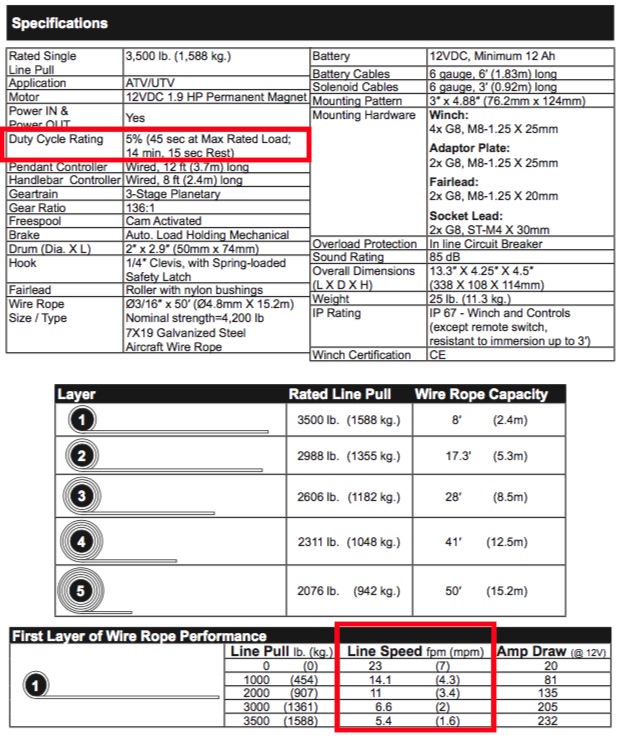

Hello all
I want to put an electric winch on the front of my L3301 to be used for pulling logs out to my trails for hauling back to my work area. Does anyone have experience with installing/using an electric winch on Kubota's? Any warnings or suggestion or just plain advice on what you have done?

No experience installing them, but have you considered how slow it’s going to be and the duty cycle? The old timers with their mules would be faster.

Here are a couple of data sheets for electric winches, HF 3500 and 9000 pounds. Note the duty cycle if run at full power, and the line speed.
I've got several electric winches and won't use them for logging. I use cable and pulleys, pulled by a Jeep or tractor, to get the logs to the road.

I have a winch on my ATV that I have used as a baseline for expectations. My property is very hilly and have to keep the tractor on the trails which means a lot of the trees I take down I am not able to get close enough to grab them without a winch.

If you've got a halfway decent amount of logs to move, buy a skidding winch. I have a Farmi 351. Absolutely LOVE it. Can't say enough how great it is. If it was stolen tomorrow I'd order a new one. They're not cheap, but they're worth every penny. The Norse winches from Labonville are the lowest cost brand and seem to be very good. Seriously, worth the money. I'd never consider using an electric winch for logs. Too slow, poor duty cycle, and too much strain on the charging system of the tractor.
