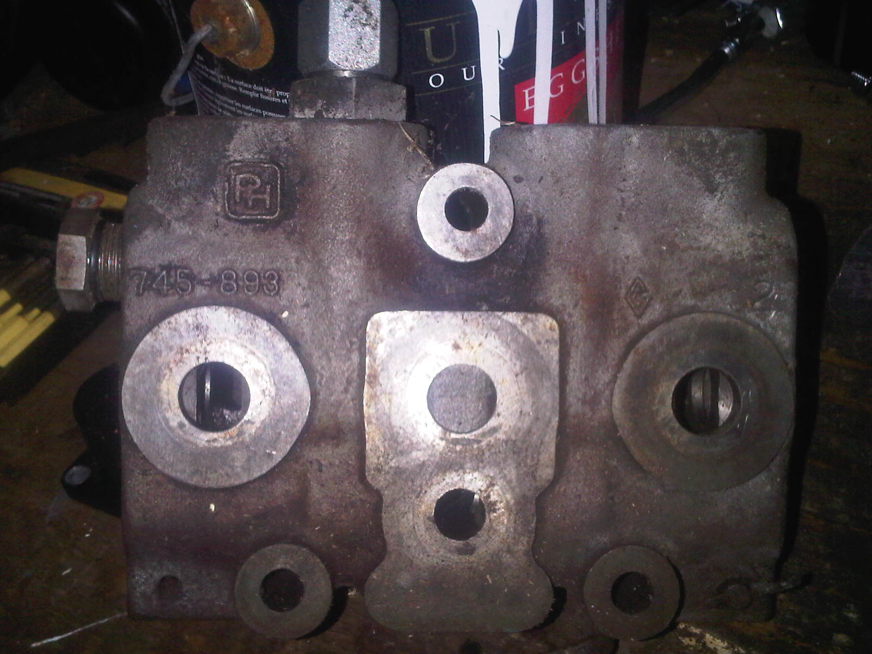

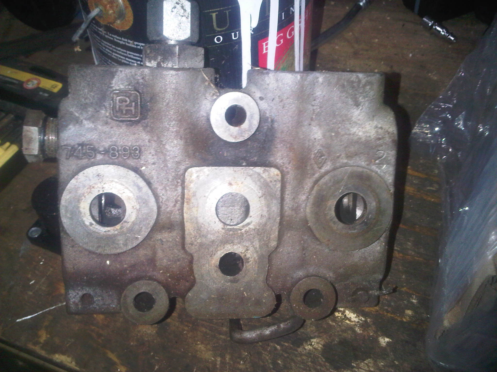

I may try to find a 2 way detent for the valve bank I have and rig it uo with linkage. It may be easier if I can locate the detent. The valve has a PH symbol on it with a square outline around the letters. I sent a pic to Parker Hydraulics to see if they can identify the beast. Yes it could be hard on the digits witn no emergency stop.
   / Electric valve
This is the animal is anyone recognizes it.

For a single cycle operation fwd and return to neutral, this valve is the way to go.
Surplus Center - 1 SPOOL PRINCE AUTO CYCLE LOG SPLITTER VALVE W/PB
If you want full automatic operation, that the cyl would go in and out by itself and keep cycling. Then electronics can do that, but you will sometimes have to wait on the cyl to return.
The one complete cycle auto valve does that at your pace.
When you are all set to split, push or pull the levers to start split mode, and then get the next log ready. It stops when you stop.
