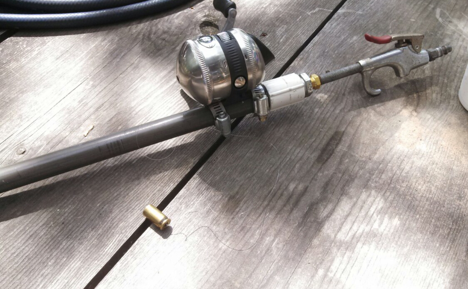

I didn稚 know anyone sold them.
I use an air blower, PVC pipe, fishing reel and a 45 ACP case with a cotter pin in the flash hole to tie the line to.
Blow it over the branch, attach stronger cord and pull it over, then can attach and pull over the big stuff.
