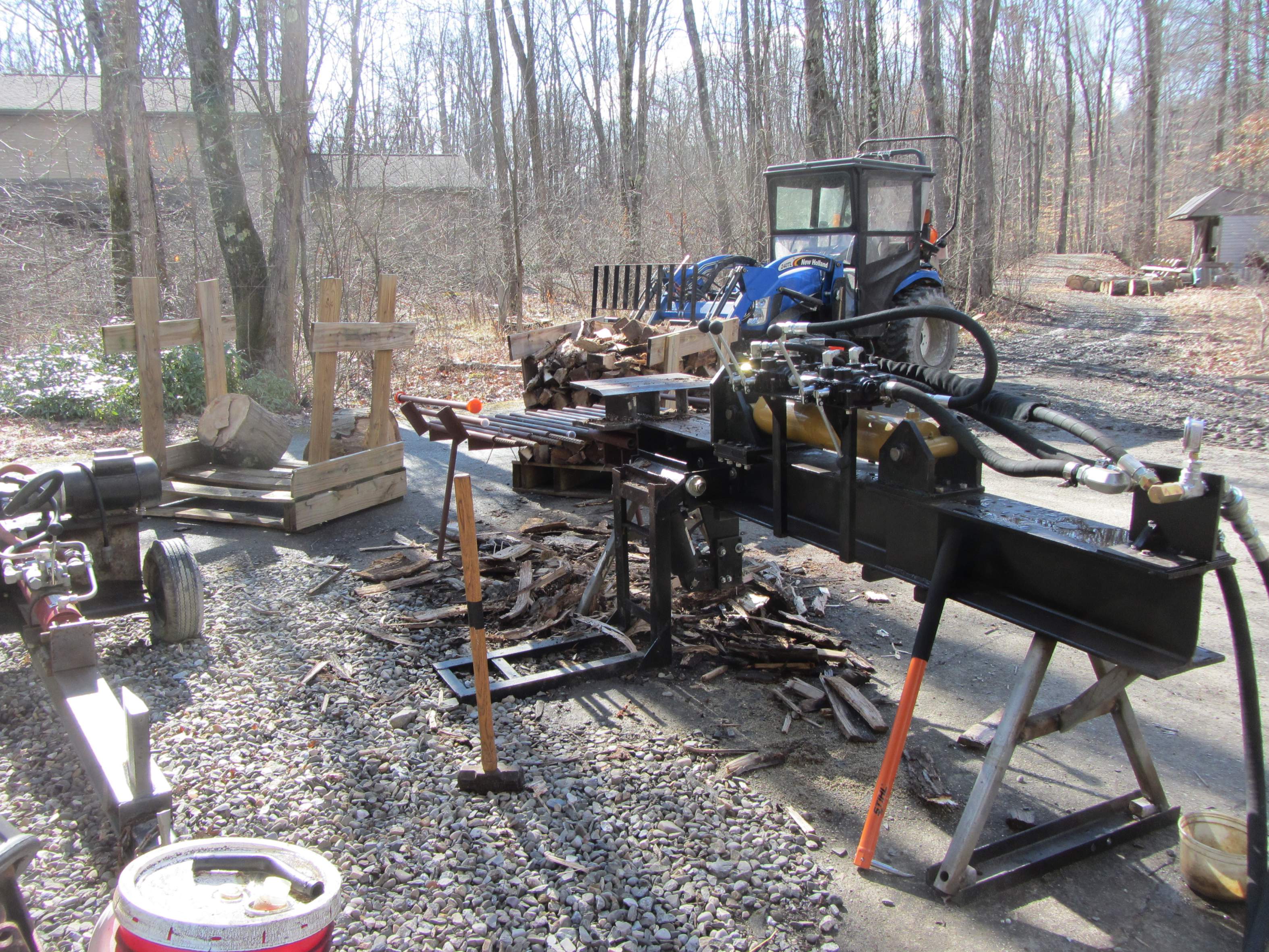

IMG_0214.jpgIt's working great. 16 gpm pump pressure set at 2000 psi. 3/4 hoses on pressure 1 inch on return. 1/2" to the cylinder. cylinder is 4.5 x 20 2.25 shaft. That size motor single phase needs a 30 amp breaker and #10 wire .
