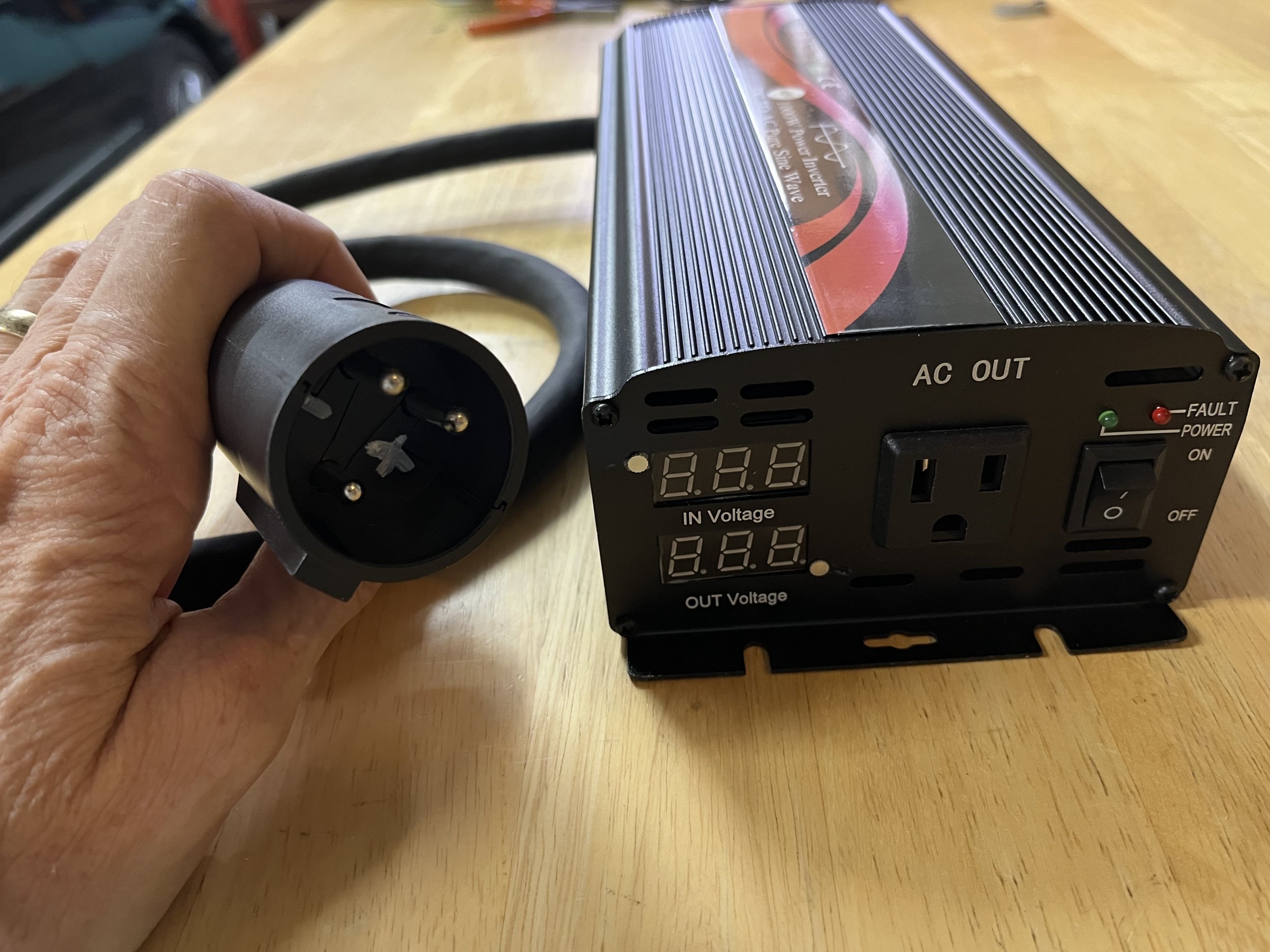

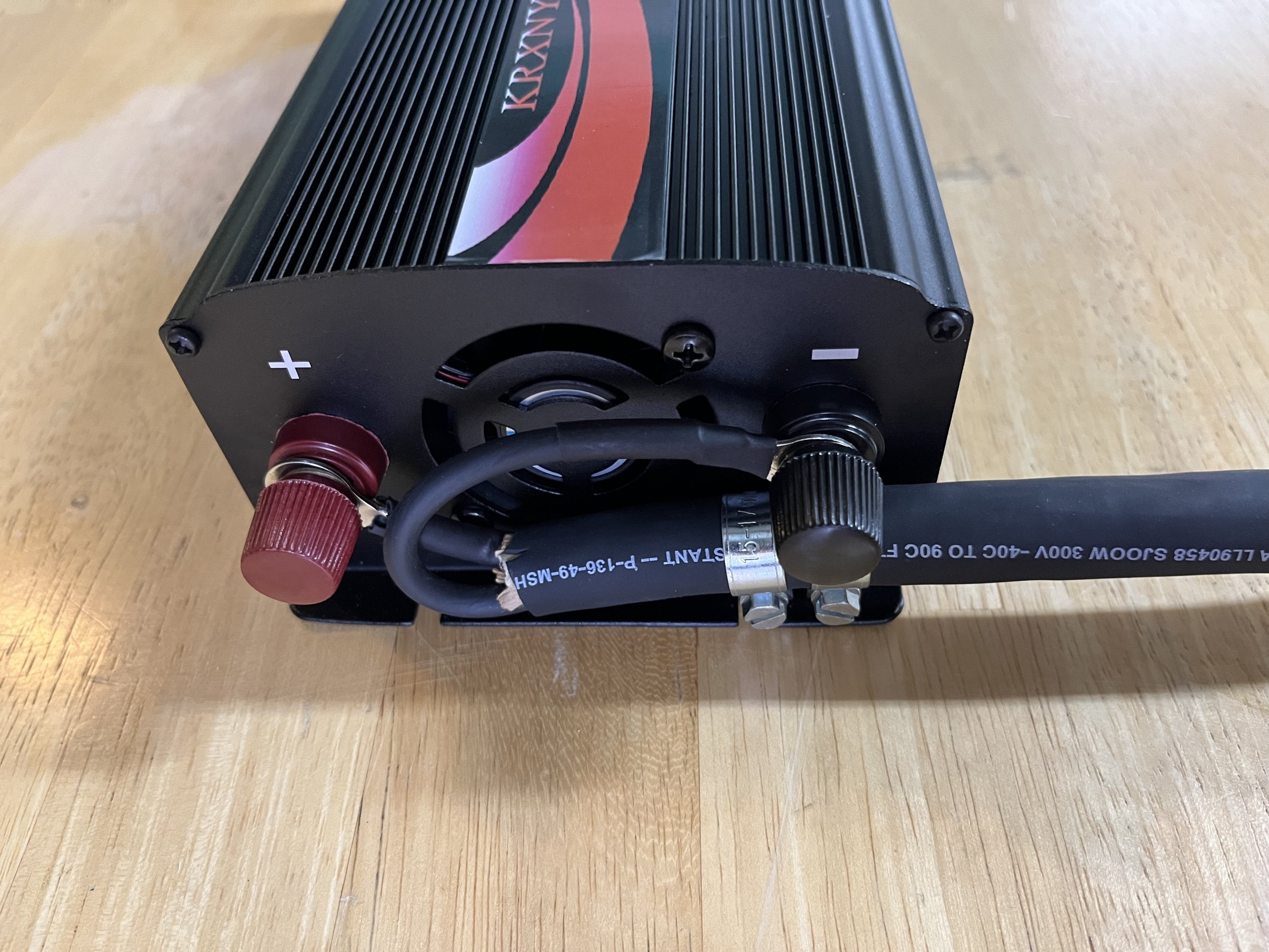

I had exactly the same thought. All that capacity in a mobile cart. I can use that! So, I just finished mine yesterday. I bought a male socket for the charger plug on the golf cart. (Safe access to hi amp 48v) Wired it to a 1000w “pure sine wave“ inverter, with a piece of old generator power cord. The golf cart charger port is labeled “20 amps”. Total cost was about $150 with amazon pieces.
I drilled two holes to hold some hose clamps for strain relief.
I trimmed the hedges last night using the golf cart headlights, and the inverter running the hedge trimmers. Everything worked perfectly.
