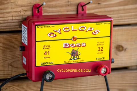

Peaches are coming on and I'm having electric fence issues. last night I was testing the fence and found I was not getting a pulse every second, maybe every 4 seconds. The charger is clicking/light flashing every second.
I used the tester on the fence and "sometimes" I would get a full reading. Other times I would get nothing just holding the tester. I even touched it with the back of my hand and nothing. Tried again and got a shock.
Then I disconnected the the hot lines from the charger and tested from the ground lug to the hot lug, nothing. Then using an insulated bar I touched the ground lug and slower moved towards the hot lug. It would pulse every second but it had to be within 1/8 of an inch. I have seen it jump a gap of 3/8 inch in the last few days though.
Is this controller dead?

It's obviously not dead but should probably be in intensive care. If you can't repair it replacement time may have arrived. The old mechanical fencers had a replaceable vibrator can thing but the newer ones are all solid state.

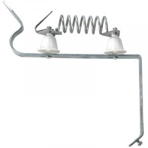

I noticed when sever electrical storms come thru the area, even a few miles out, the fence energizers would tank. It didn't matter what brand either. Got tired of replacing them. I then found the Zebra brand has a lightening resistance add-on. Since adding them, I've no longer needed to replace the units. The units are getting very pricey too.

@Paddy The reduced spark gap suggests a dying charger, as does the irregular timing.

FWIW: We installed lightning arrestors on our electric fence when we set it up, complete with separate grounds set 10' into an area of soil that stays damp. Despite lightning strikes near enough to take out the utility electrical power transformers over several miles, there was no effect on our charger. We used a Gallagher model that is adjustable;
So, yes, another vote for adding a lightning arrestor.
Premier1 Fencing recommends a lightning diverter/choke every 1/2 mile;
We don't have one, so I can't comment.

I started using a L Diverter after this thread some years ago , and I have had pretty good success down here in sw Fla .
We get lots of electrical storms BTW. Not 100 per cent foolproof but good cheap semi alternative insurance.
Dang worth a try imo for someone interested in it .
