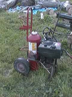

I made a portable power unit from a wheeled fire extinquisher and use it to run the splitter and various hydraulic jacks.
Now that's clever!
I've turned a lawn mower into a generator with the addition of an alternator, but wouldn't have thought of making one into a hydraulic power unit.
Nice.
