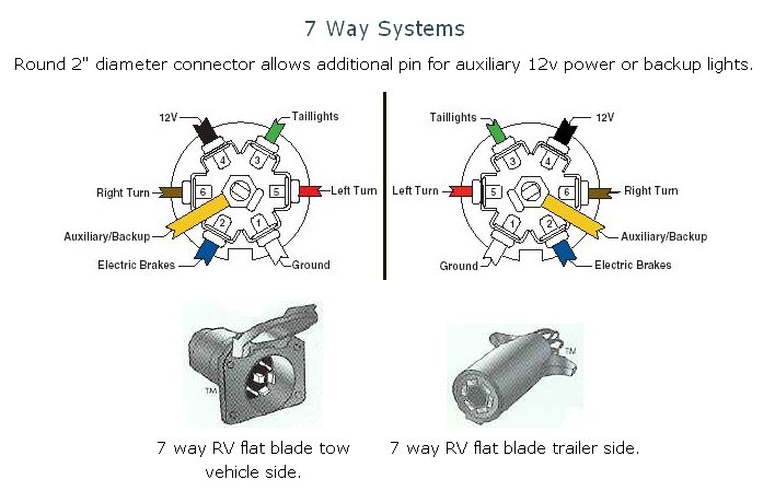

I replaced all my existing trailer wiring connectors that weren't already 7 pin with the "RV" Bargmann style connectors and plugs. This is pretty much the standard now around here anyway. I used to mess with adapters, but I have found them to be unreliable.
