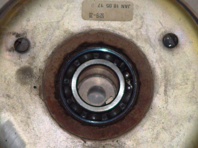

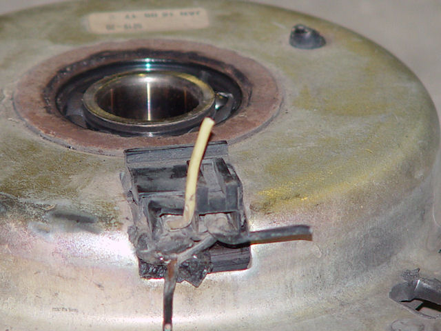

At least you got 230-hours out of your clutch. My 2005 JD L130's clutch puked at 56-hours. If you look closely, the bearing cage tore itself up, which seized the clutch and no doubt caused it to fry. The melted OEM connector is part of the wiring harness, so I took the parts guy's advice and used insulated connectors and a Sharpie pen to high-tech label which color wires went where on the new clutch.
If you had smoke coming from the clutch, it's shot. After you replace the clutch, and it still doesn't engage, then your PTO switch got fried too. That's what happened to me, a new PTO switch was $20, a new clutch $155. I had to make a wrench to hold the engine from turning while removing and installing the clutch mounting bolt to the engine shaft. Removal of the bolt required a borrowed impact wrench, and the 7/16" GR8 bolt took 78-LB/FT of torque when I put it back on.
