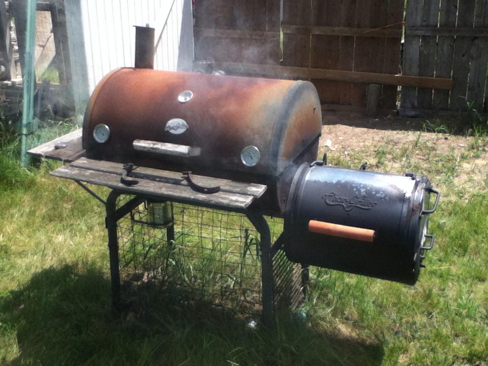

We run anything maple in the woodshed short enough to fit in the firebox, split it into kindling in the early stages to help get the fire going, but once there is a bed of coals just put in anything that will fit. Sometimes white or red oak, too. Anything I can't identify stays in the shed.
Not very good at smoke control, mostly I just try to keep the temp in the right range and let the smoke do what it will.
This model of smoker comes with a charcoal tray for direct grilling, but we never used it. So when the firebox burnt out and we replaced it, I yanked the tray and put in a row of baffle plates, maybe 6" wide with a 1/2" gap or so. Between that and the two thermometers down at grate level we are doing better at temperature management, the grates can be as much as 100F hotter than the top of the box where the original gauge is. Got those two tips from a BBQ forum, and they do help. The fencing around the legs to keep the dogs out of the grease cup was my own idea.
The firebox is often sold as a stand alone "tabletop" grill, which is how I bought it for replacement. I don't see why you couldn't grab one and add it to a barrel, if making up the whole works from scratch looked like too much work. They go for between 50-70 US.
I was given a gas smoker unit a while ago based on a large pot burner, with extra baffles and water tray and such, but have never used it. It looked way too complicated, but if I wanted a colder smoke for something like fish I might be tempted to set it up.

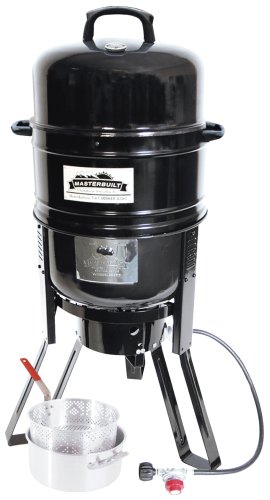

smoker.jpg I scored one of these, with a cover, that was almost new at a yard sale for $40. I didn't even haggle. Works great. Set the electric element and let it run.
   / El cheapo Brinkmann Smoker #10
I bought one of these, the propane burner does a good job of keeping an even temp. I've only used it a couple of times, but am happy so far.
