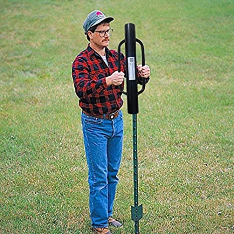

I did over a mile of fence with one of these, you lazy bum. :ROFLMAO:
   / Educate me on post drivers #4
That doesn't seem to fit split locust post very well 🤠
